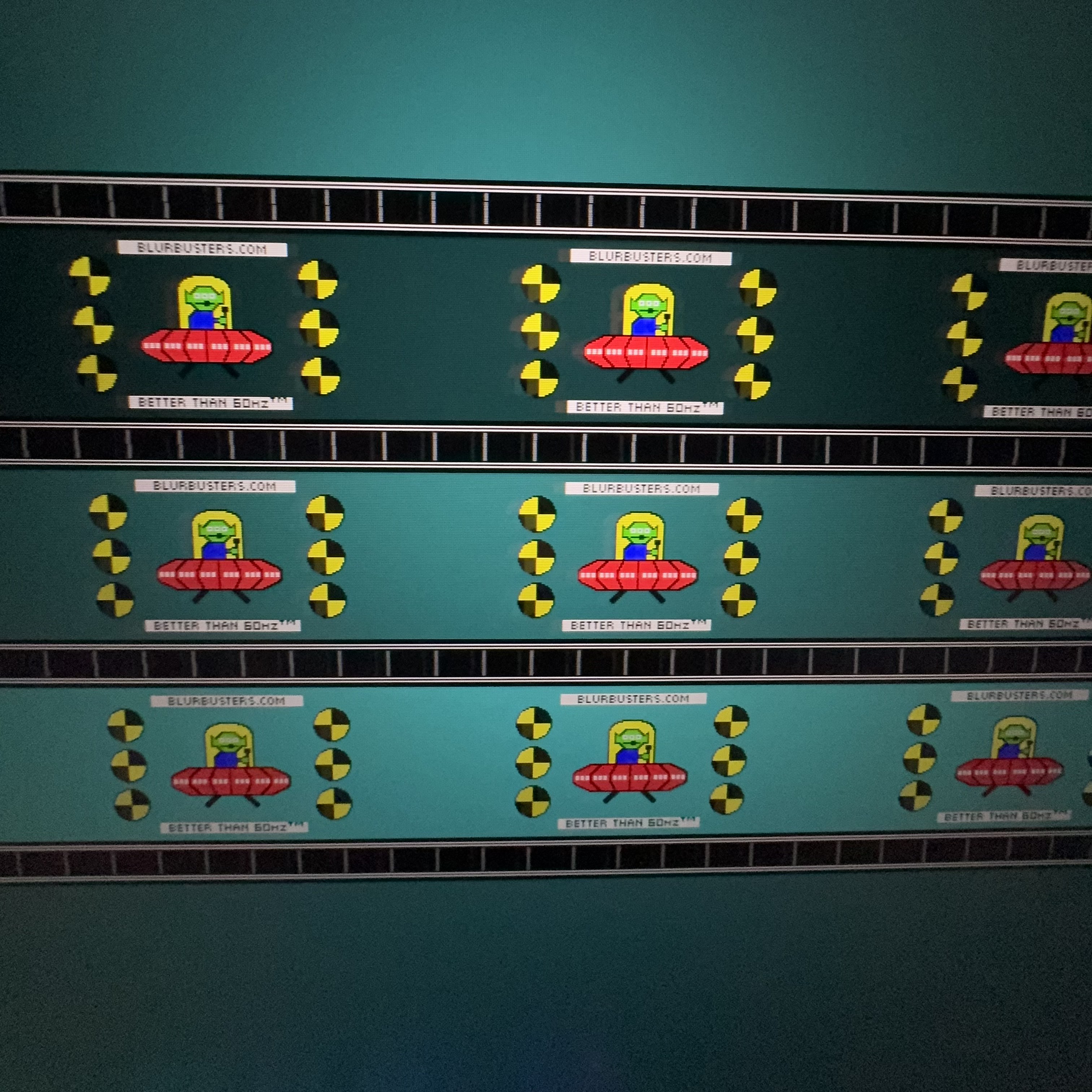

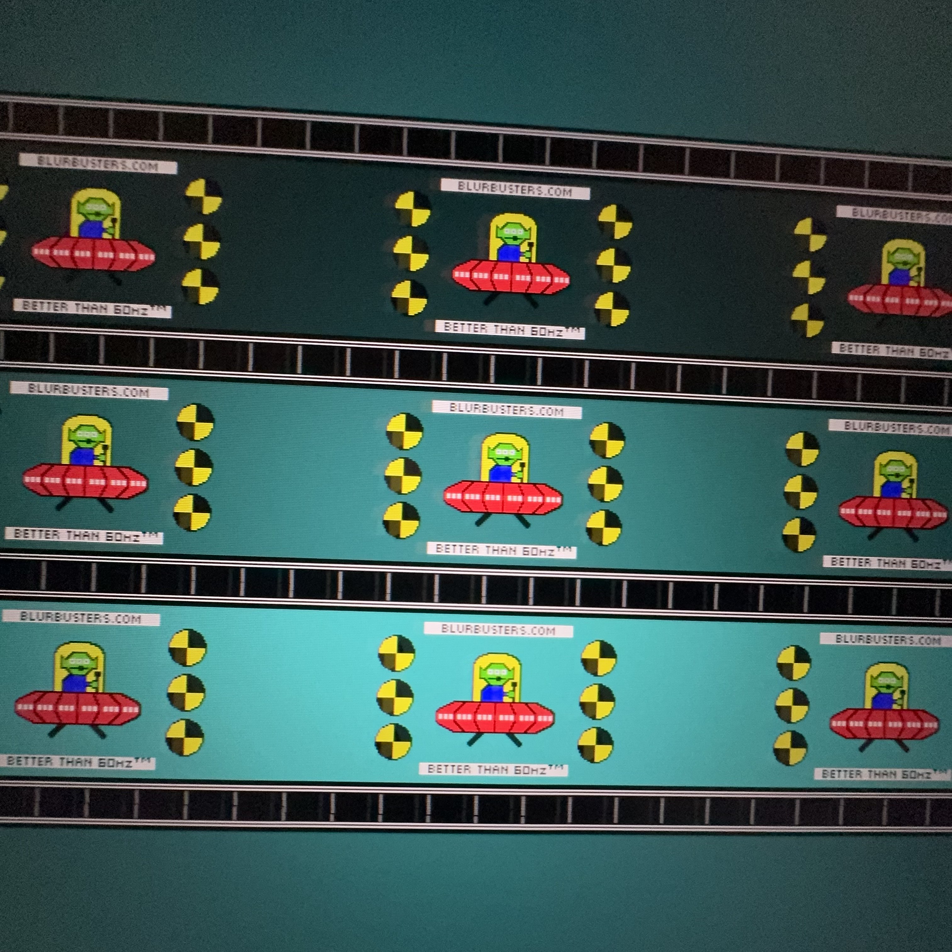

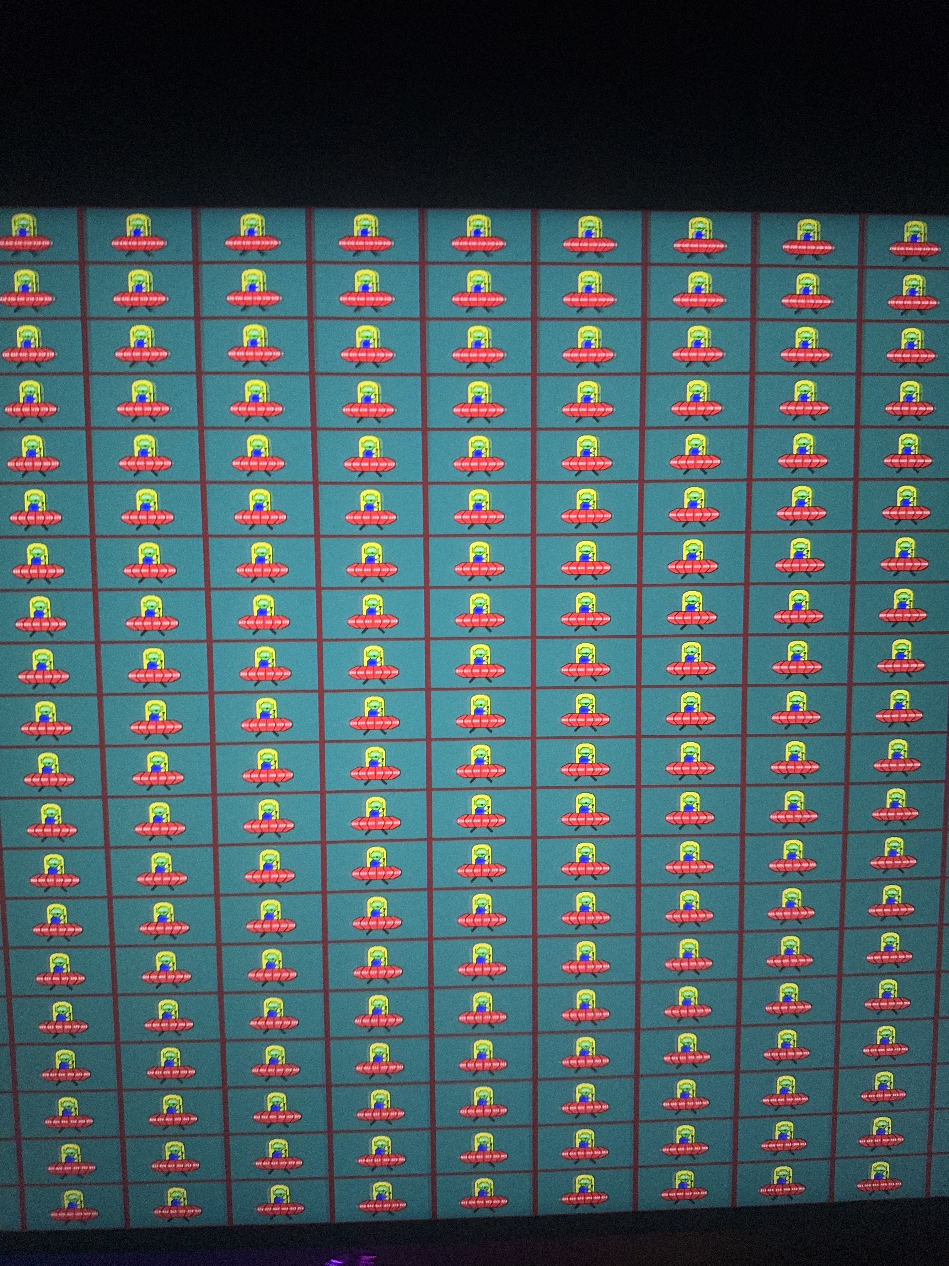

FW 1.1.10 360hz PW10 ULMB photos
Taken 1/90sec shutter, this time as an actual photo instead of picking frames from a video
My best testufo shots taken at 2520px/sec (2400 selected on testufo)
Strobe crosstalk test at 1800px/sec (1920 selected on testufo). Had to slow it down a bit to get a decent photo, still shows where the sweetspot is tuned.
Crosstalk definitely is creeping in alot more, but I am surprised the sweetspot is as large as it is for an IPS panel at 360. Will shoot some 240hz photos next

Honestly I think that's an acceptable amount of crosstalk given how much clearer it looks now. Gsync pulsar works more consistently for sure but we are still at the mercy of game engine/optimizations for it to work well. Wardogs for some reason doesn't look as good at 144 fps or above with Front edge sync cap than it does at 120 fps or below with front edge sync. If I use Vsync + Gsync + reflex it looks worse, I think there might be more improvements that could possibly be made between 130 hz - 200 hz but maybe I'm wrong

A nice upgrade. I do wonder what the limit to the blurring is.
I assume 3840px/s & beyond would who artifacting, though PG27AQN isn't exempt from this.
The prediction for the lower PW region for 240-360 Hz is definitely wrong though, as these UFOs seem like ~1px of blur to me.
This would imply ~18% duty cycle @ 360Hz @ ULMB2 PW=10. Exactly how these monitors should've shipped on launch :)
