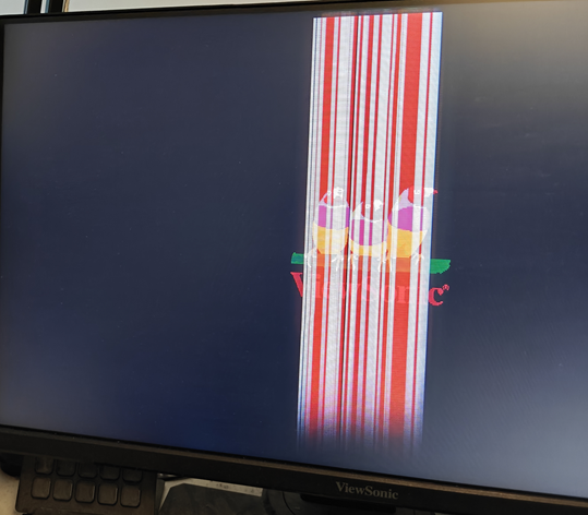

XG2431 I bought in september 2022 developed a defect of horizontal lines forming above and below anything drawing on the screen, including the ViewSonic logo during power on. I see a decent amount of posts of this issue on other boards.
I really enjoy the feature set of the monitor. Like I happened to post here earlier the blur reduction with custom QFT can be great at 60-100hz, a nice CRT replacement. But I wonder how long the average XG2431 lasts/return rate.
Interestingly on my unit theproblem has so far been essentially unnoticeable when running at stock 240hz or custom resolutions with maxed out vertical total/pixel clock. At first I thought this might be a strange issue with my PC POST screen. The issue really appears at stock lower hz, or plugged into a console where the screen becomes unusable as it gets filled with horizontal lines that stack up on top of eachother and dont disappear.
If the RMA process goes well from ViewSonic I might replace my 2nd monitor with another XG2431 or splurge on a XG272-2K OLED (BlurBusters verified..?), but better wait for reviews on the latter.
