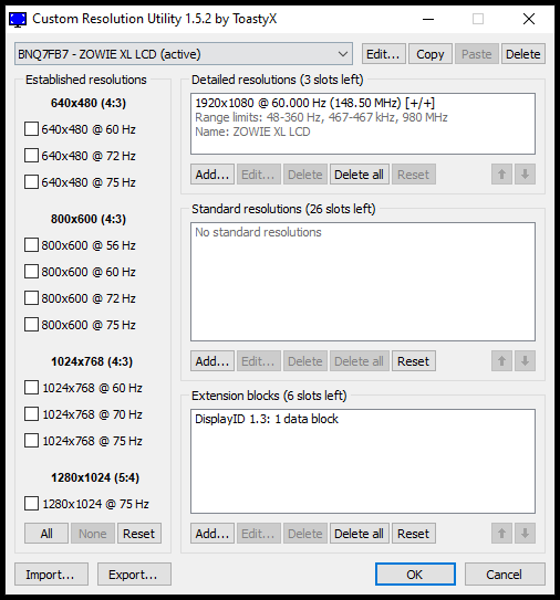

How to use Quick Frame Transport (QFT) tweak on xl2566k via CRU 1.5.2
1) If you use custom resolution for this monitor (like extract reduced) you need to run reset-all.exe and restart64.exe for reset display resolutions (you need default res profile)
2) You need to remove all unnecessary resolutions, exept 1 detailed resolution (this 1080p60hz need to open Valorant or Fortnite games)
It is also necessary for standard xl2566k profiles such as (1024х768,1280x960) to work when using Display Scaling

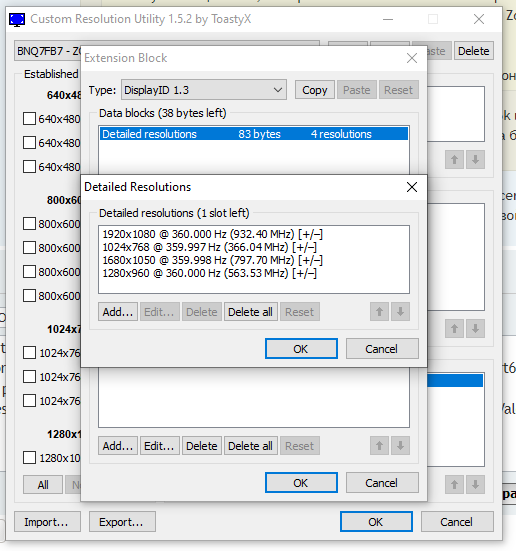

3) Go to DisplayID --- Detailed Resolutions
4) Open 1920x1080 360hz profile
5) Click Copy and close it
6) Click Add...
7) Make Paste

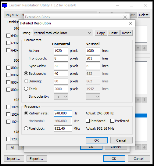

8) Find Vertical Total Calculator in Timing section
9) Put in Refresh Rate what HZ you need (im take 240hz)
10) Click OK 4 times and start restart64.exe
