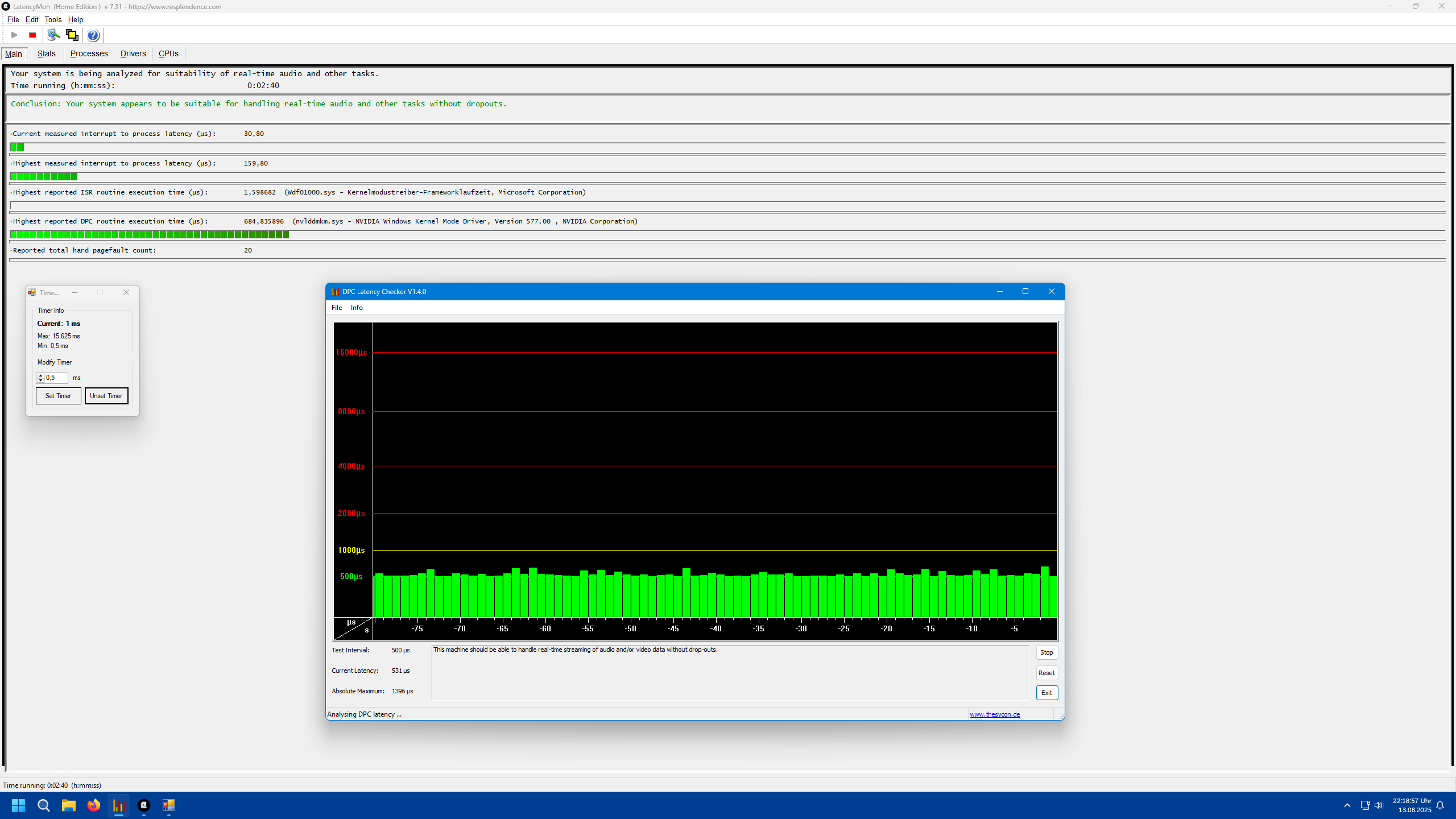

by LaggyTyp
I can't disable spread spectrum on my Asus Z690.
Battlefield 2042 or Battlefield 6
- No packet loss (at any time)
- Ping = 12-15ms
- Jitter = up to 2ms
- No error messages
Gameplay:
- I'm not in the action, but in the past
- I need many more shots than others
- No hits from mid-range
Screenshot (162).png (111.5 KiB) Viewed 1855 times
Re: No FPS gaming possible
Posted: 13 Aug 2025, 15:26
by Fpsgamer
LaggyTyp wrote:
13 Aug 2025, 15:22
- Ping = 12-15ms
- No error messages
Gameplay:
Every PC is different, I can't tell you 100% what causes it.
Best thing you can do on windows is make sure you have high/ultimate power plan and good nvidia and ethernet settings.
Also enable MSI mode and set everything to undefined and make sure you have the right drivers for chipset/nvidia/ethernet/audio.
You don't need to mess with timers.
https://imgur.com/a/cItdLzj
Having a good latencymon on w11 is harder than w10 but doable.
Latencymon looks good, don't worry about it.
