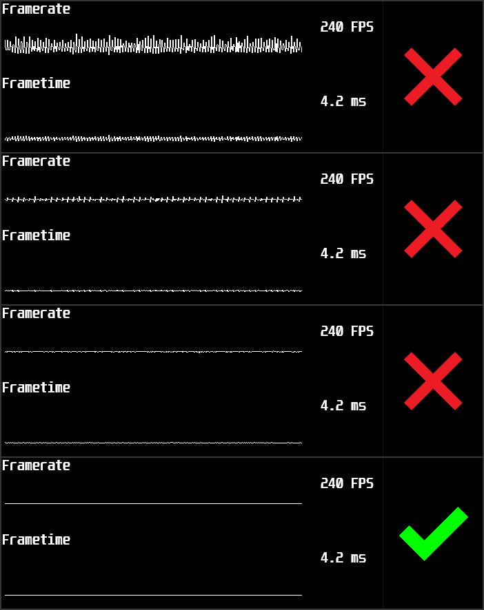

That is probably because u are not using it correctly. Everybody is praising DyAc and other blur reduction modes, but I bet 90% of users don't utilize it properly. Keeping framerate unlocked isn't ideal for motion smoothness. You want perfect Frame rate = Refresh rate and flat frame times to avoid jitteriness or tearlines. Especially in low persistence modes where jitters get more amplified. The problem is achieving that perfect sync. There are now couple of third party limiters that can do this, but it can still be unstable and add some minor latency. Thats why DyAc Sync (DyAc+VRR) would come in real handy. Unfortunately they didn't implement such feature.
Frame Rate Limiters and Frame Pacing.png (23.73 KiB) Viewed 8683 times
Good luck achieving perfect sync without VRR.
