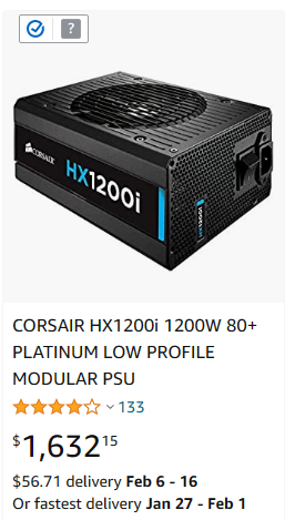

pox02 seems to have the HX1200i but I am not able to find anything at a good price here in North America (Canada) otherwise I will chase for Seasonic as he did advise.
HX1200i Overpriced Canada
2023-01-20 21_24_56-Amazon.ca _ HX1200i and 3 more pages - Personal - Microsoft​ Edge.png (65.11 KiB) Viewed 6868 times
