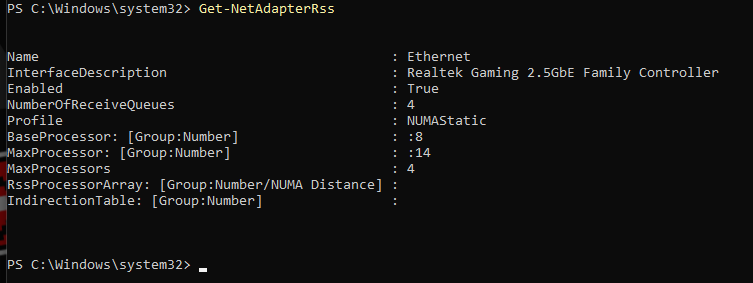

After entering your script - now I see number of rss queues, receive side scaling and rss load balancing profile in the advanced settings in device manager. Its set to 4 and rss load balancing profile set to numastatic is this right?
I'm not sure if its working because the indirection table is empty though.

what driver are u using ? and Could you please tell us your setup (MB, cpu) ?
because my results are as same as BlurWickd, IndirectionTable and RssProcessorArray are empty and we have same network card; im confused.

I used the latest on the realtek website, the one that doesn't support powersaving. The odd thing is that I reinstalled the one from my motherboard site which seems to be the exact same version yet the indirection table is full now and it has rss already? wtf?
7950x3d, MSI x670e TOMAHAWK Wifi

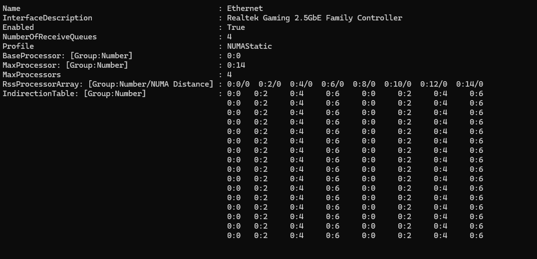

Post by jassine » 26 May 2024, 17:58
BlurWickd wrote: ↑
26 May 2024, 16:57
I just did what you did, i installed realtek driver from their website, then installed my MB's driver (Gigabyte B550 AORUS ELITE V2 rev 1.4) and boom, i have everything, thats weird.

Post by JimCarry » 26 May 2024, 18:23
BlurWickd wrote: ↑
26 May 2024, 12:23
jassine wrote: ↑
26 May 2024, 09:09
can someone with RSS enabled share the result of: Get-NetAdapterRss
Disabletaskoffload to 0 and indirection table should be working

Disabletaskoffload is 0 if indirection table has number in it,it means on boar processor on realtek is on and working.
