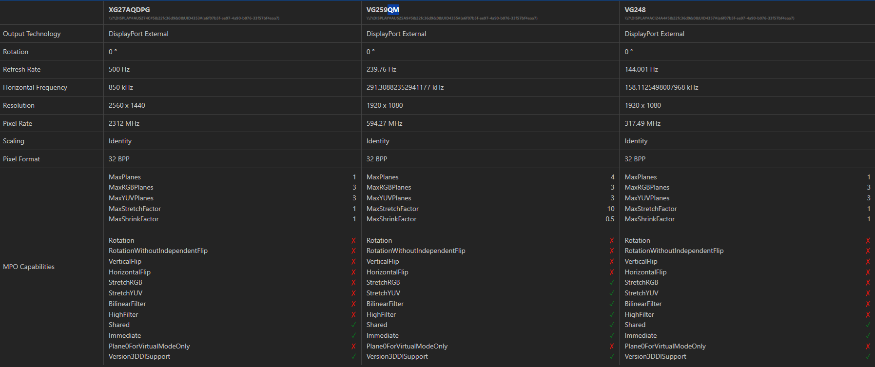

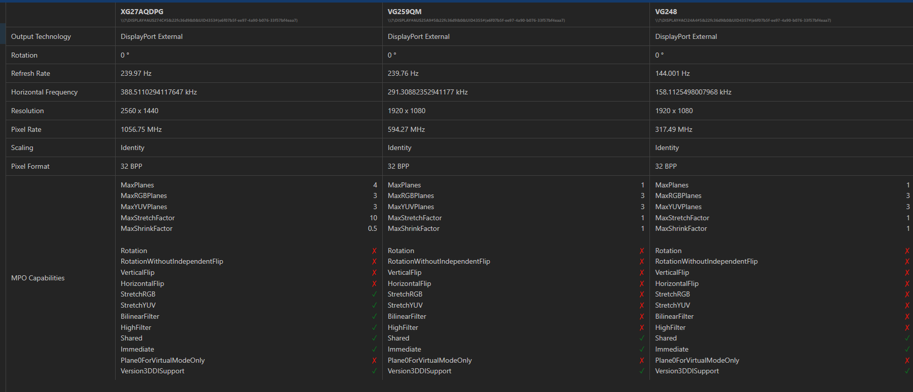

I'm not saying it adds anything on the actual compression level, but it is preventing MPO and I can't even get Independent Flip to work. I'm not sure why you are so upset with me, I'm just presenting it as I understand it. Perhaps these will be of help - one is 500hz with DSC on, other is with DSC off and using max supported 240hz. As you can see, MPO triggles then. I then can play at 240hz and have independent flip mode presented via presentmon monitoring.
