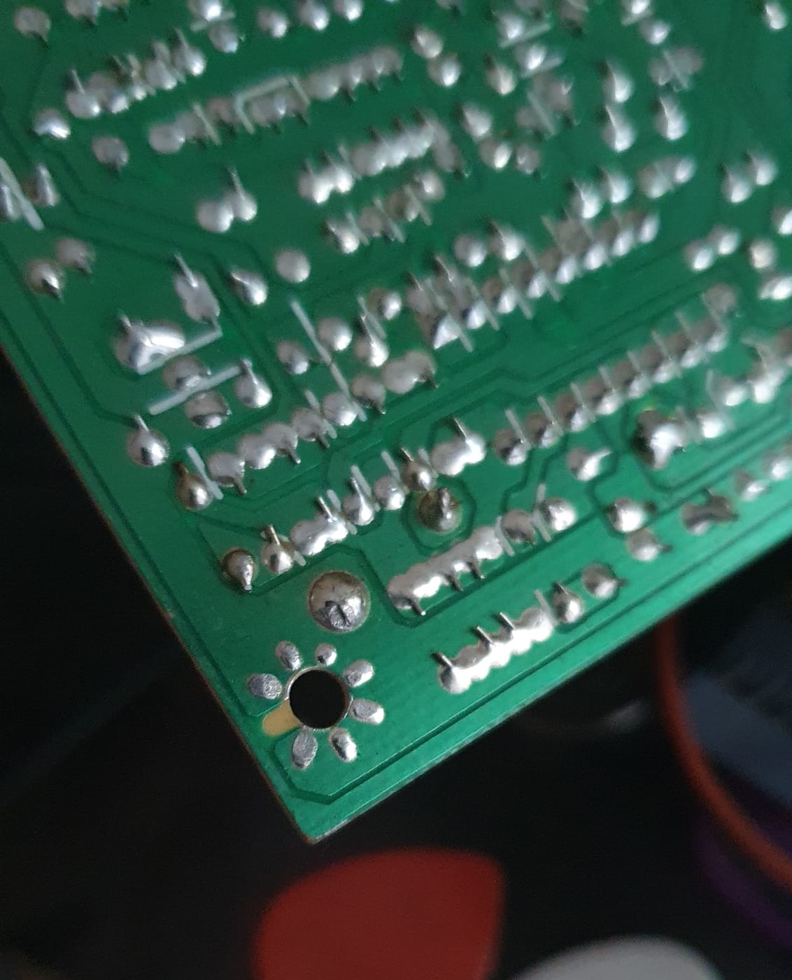

I've read this a while back and though about a temporary workaround. I measured a voltage difference between the back of my GPU and the PSU screws. I tried to create a low-resistance path for some of the current back to ground via thick copper wires running directly between the PSU and GPU mounting plate. I've detailed this in a posting in another thread. It's here: viewtopic.php?f=24&t=13054&start=190#p114932. There's also an image attachment there which shows my, admittedly crude, implementation: https://imgur.com/a/ruXGZWr
This 100% exists and is a problem in the real world. It's most likely responsible for melting 12VHPWR cables on high power draw GPU's. If this can create enough interference, well the article's author certainly thinks so, and that guy definitely knows what he's talking about.
Now, here's the weird part about this. Since I've employed the "technique" in this thread, by plugging in all my devices in the "correct" order, I'm no longer so sure this is actually a thing. With my current setup, it's virtually impossible to break it again. Only when moving the plug it starts to get worse again. The workaround with the wire doesn't have any impact any longer. My system works with and without it. To add to all that, the back of my current GPU and PSU don't show voltage differences any more, and there's no more stray current on the DP cable, even with a grounded monitor, leading me to believe my old 2080Ti had a hardware defect somewhere and it was leaking voltage.
As you can see psu metal case is connected to circuts ground , I wanted to lift them long time ago but got lazy , maybe I will now.
