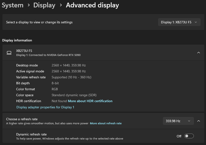

I would try:
  • Resetting the monitor to default settings.
  • Another DP Cable.
  • Disconnecting secondary monitors.
  • Uninstalling Nvidia drivers with DDU and reinstalling the latest drivers.
Also double check settings within Win11 and NVCP regarding variable refresh rate, dynamic refresh rate, G-Sync, etc.

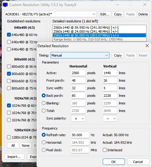

I think its possible within Windows, I made a custom resolution of 50hz with the CRU program and it seems to work, I would need someone else to confirm. CRU settings below:
I did play a 50fps video on YouTube and it looked smooth and clear: https://www.youtube.com/watch?v=-HqB15g_sCA&t=21s
Note this mode flickers even more than the 60hz mode! The 60hz mode flicker doesn't bother me but I think this would bother me using it an extended time.
The pulse width adjustments are still available in this mode too.

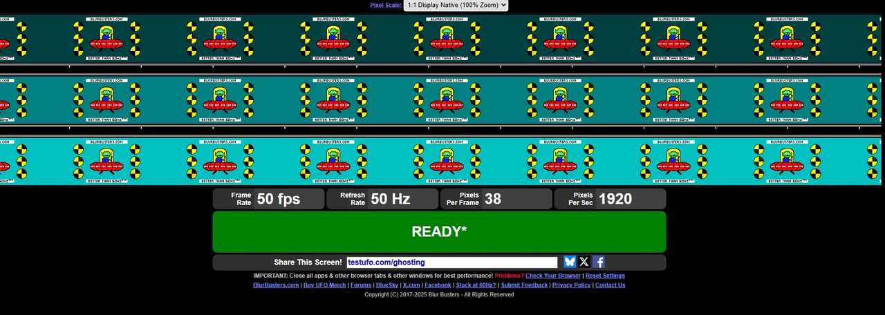

Checked UFO test and it confirms its 50hz, it also says on the Acer OSD that its running at 50hz.
