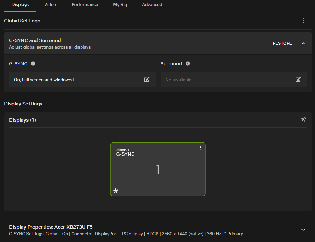

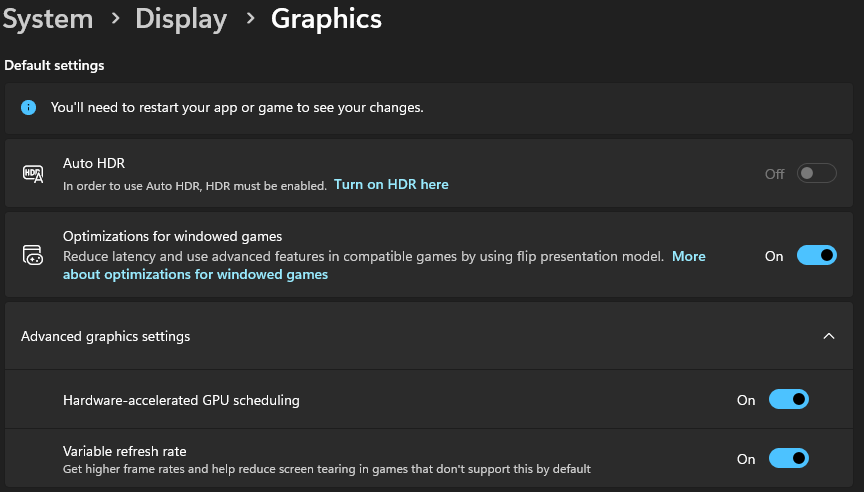

I would try:
  • Resetting the monitor to default settings.
  • Another DP Cable.
  • Disconnecting secondary monitors.
  • Uninstalling Nvidia drivers with DDU and reinstalling the latest drivers.
Also double check settings within Win11 and NVCP regarding variable refresh rate, dynamic refresh rate, G-Sync, etc.
Screenshot 2026-05-17 171045.png (46.33 KiB) Viewed 3142 times
Screenshot 2026-05-17 170943.png (59.22 KiB) Viewed 3142 times
Screenshot 2026-05-17 170841.png (43.8 KiB) Viewed 3142 times
If problem persists, you can even try rolling back to a previous firmware. But 1.1.6 is working fine for me.
I hope you can solve it. Good luck!
