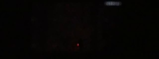

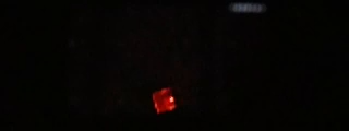

Sparky wrote: LED and resistor choice shouldn't matter much. What do you mean by not lighting up immediately? As in you can see physical movement of the button before the thing lights up? That would be caused by a combination of switch actuation point, the time it takes the switch contact to fly across the gap, and possibly bouncing, depending on how long your shutter is open.
LED lights up to full state in more than one frame (0,833 ms).
Let me show you:
start of LED lighting up (condition A):
the next frame - LED ok (condition B):
As you can see little red dot at "condition A" is LED starting to lights up.
iirc most of time with my setup there is only "condition B" but sometimes "condition A" appears.
You can see videos at my prev post.

That's probably the result of a bouncing switch, or the LED turning on just at the very very end of the camera's exposure, If the mouse uses double throw switches you can use an SR latch to drive the LED, and eliminate any bounce issues.
