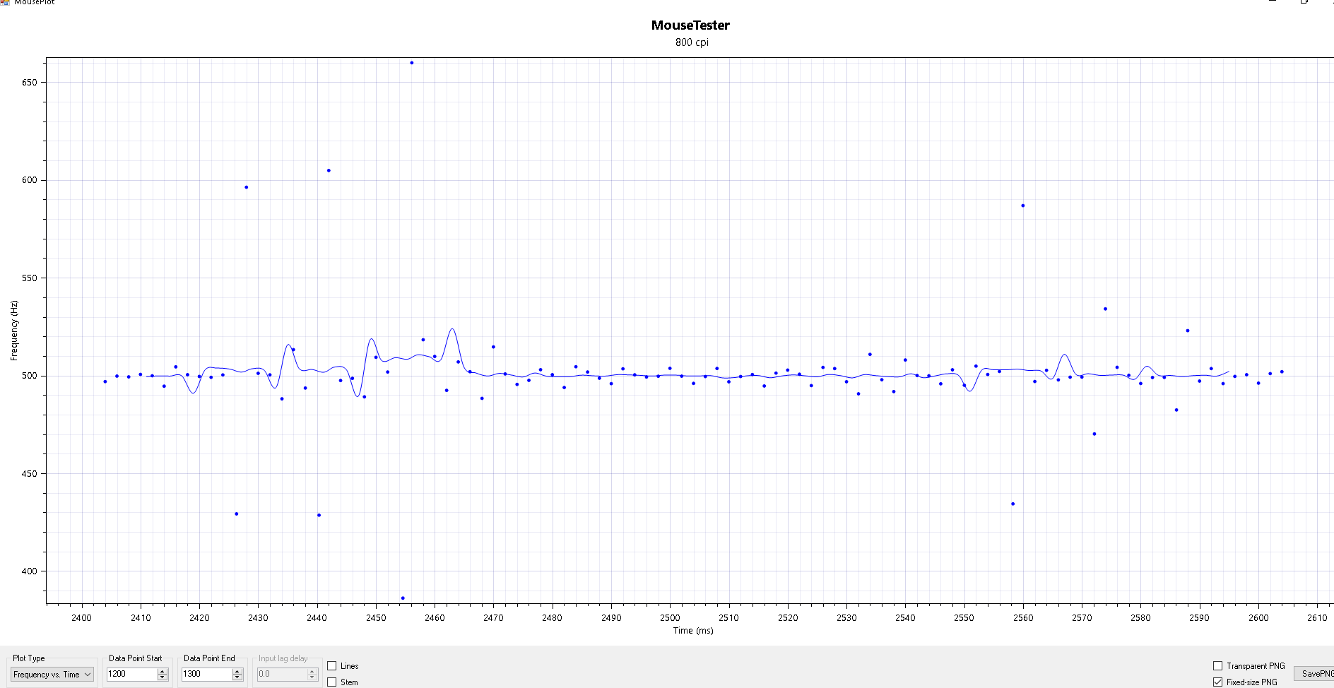

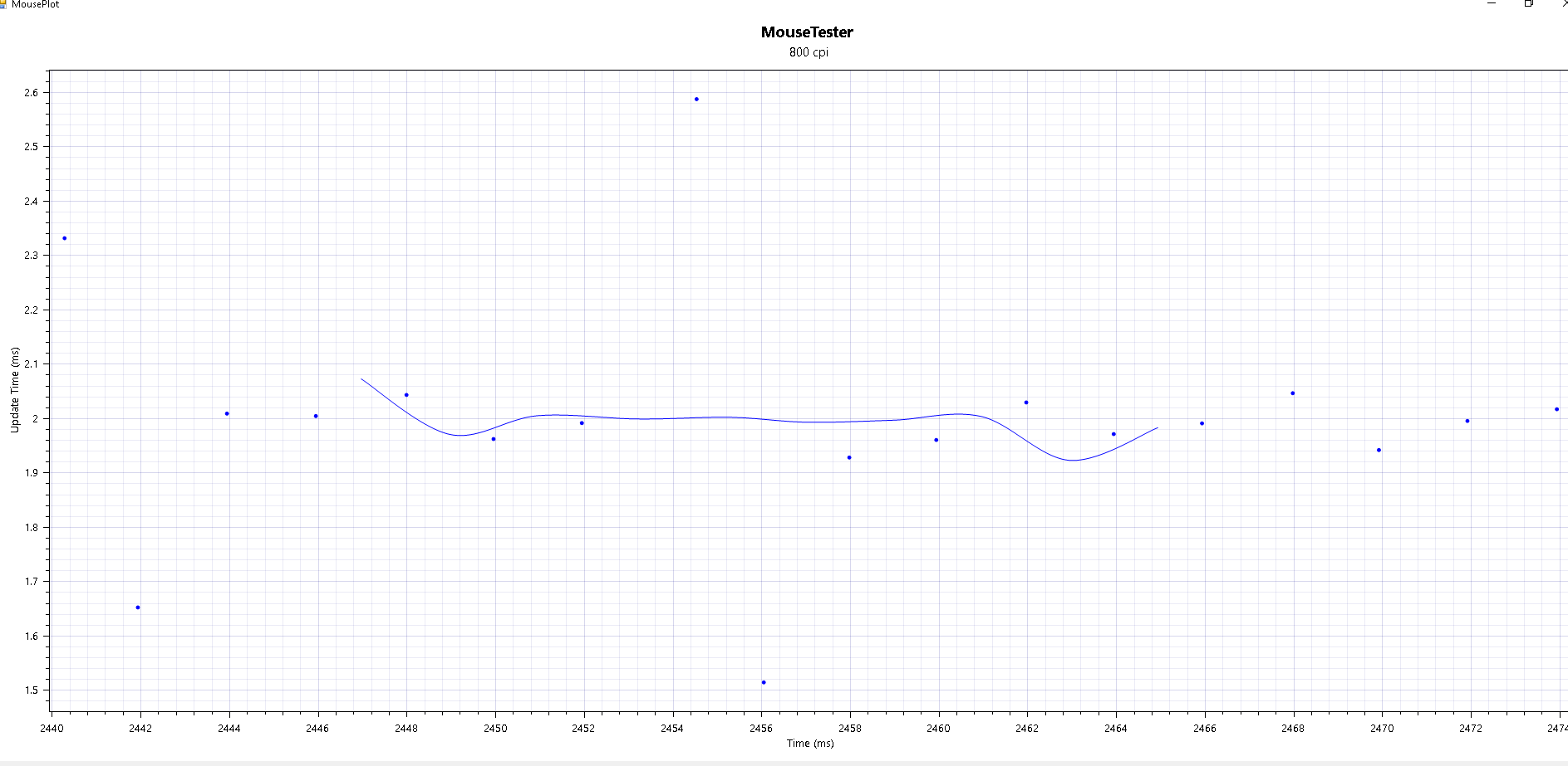

I Am on asus Z390-i gaming. I have at the top 2 (USB 2.0) ports and 2 (USB 3.1) ports. USB 2.0 is black and USB 3.1 blue. These are at the same level! https://rog.asus.com/us/motherboards/ro ... ing-model/Chief Blur Buster wrote: ↑16 Oct 2020, 00:29Solution: Serparate USB controllers and PCI bus lanes per 1 high-pollrate device
Lower there are 2 red (USB 3.1) ports. If I connected a keyboard there (it should be different USB chipset as you say) I have same results on mouse tester: as if I use for keyboard & mouse both (USB 2.0) ports!
I maxed polling rate doing quick circles and picked data from middle. I have like 10-25hz difference. This is same when I put keyboard into red (USB 3.1) port! I tried also blue port same result, not to mention when I plug both keyboard and mouse into (USB 2.0) same results... Also mouse feels weird (laggy) when I put keyboard into any (USB 3.1) port!!! Than if I had both keyboard and mouse in (USB 2.0)!!!
And I use only 500hz mouse/1000hz keyboard!
Also how do you read Frequency vs Time in MouseTester, not all categories are explained in the original thread! I thought Frequency vs Time is supposed to test polling rate stability, Windows can also affect that? I thought this would be mainly affected by a bad mouse. For DPC latency I use category Interval vs Time, which also shows polling rate. Dots are spaced 2ms each one from another in middle and these dots are also 2ms from each other during frequency (mouse polling rate "hz") spikes, which I measured in first graph! I filtered graph in time, when 2 biggest hz spikes happened both on the graph Frequency vs Time and (Inteval vs Time - second picture).

- mousetester frequency vs time.png (85.62 KiB) Viewed 27367 times
- mousetester.png (69.39 KiB) Viewed 27370 times
