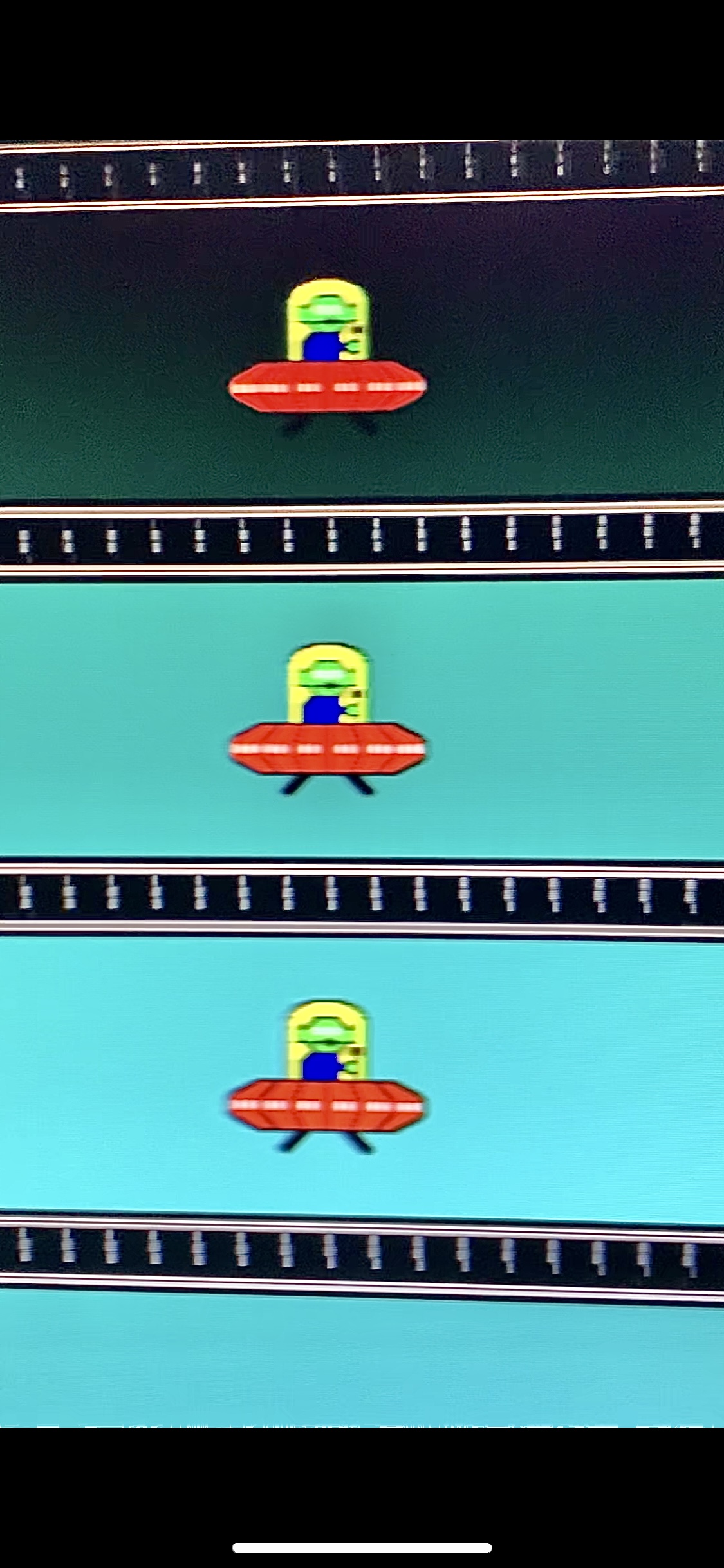

This thread is maybe dead but I share my OD 3/4 pictures of x25 f here.
Are these good shots? One of the firsts that I have ever taken...

Kosvill wrote:
29 Nov 2022, 01:51
After choosing good overdrive level try playing with contrast and color settings (RGB MYC). Sometimes this can speed up some of the slower transitions. My old TN AW2518HF did this pretty well. See first row bellow.
AW2518HF, original topic: viewtopic.php?f=23&t=6601
For better quality pursuit try keeping hands more steady when tracking. The black spacing between ticks in Sync Track indicates there was unwanted vertical movement. Additionally move camera away from screen to capture all 3 ufo rows. Usually top one always shows most ghosting while bottom one most overshoot (not necessarily). Although this might make image more blurry if camera is low resolution. For extra info see here: viewtopic.php?p=74863#p74863

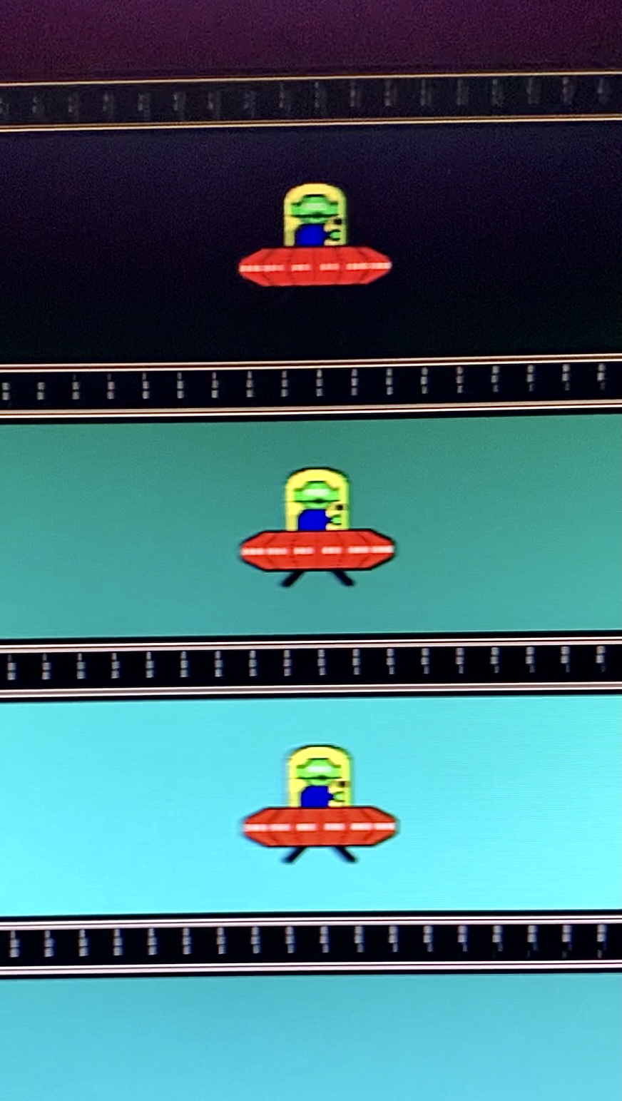

Thanks for a reply! Here is new photos, not perfect but better I think. I keep improving.
Is there hidden service menu on x25 f?
Brightness 14, contrast 80, OD 3/4
Brightness 80, contrast 40, OD 3/4

[P.S. I'm seeing severe viewing-angle issue here. For hobbyist smartphone pursuit camera -- keep camera closer to normal viewing distance away (not too close). For better stability, hold phone portrait with stiff outstretched arms, with both hands while spinning computer chair -- best not to move hands or arms, just spin computer chair. And done while the smartphone is at the viewing distance where your head normally is.]

The ufo looks better to me. There is less ghosting after contrast adjustment. Almost ghost free. At least at 960pps. That's as good as it gets on this monitor.
Pursuit camera job still isn't at it's best. Seems to be off focus or low resolution. And vertical movement is still present. If u could fix that and use 1/60 shutter speed for 240Hz to capture that one extra refresh (4 tick marks) and fix black clipping in top ufo row that would be great.
Moving smartphone camera even further away from screen would probably result in even less detailed image. But idk, I always prefered closeups for that crispy pixel detail.
