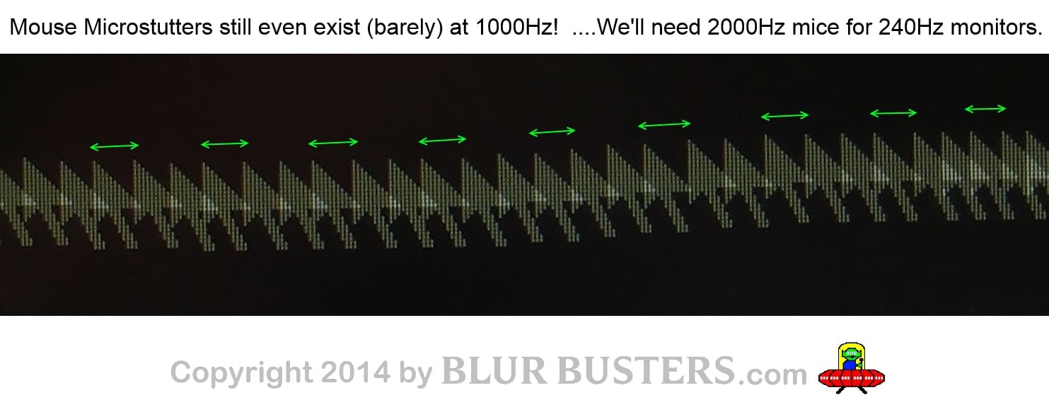

BTW, upon closer inspection, I even barely see microstutter during the "tiny text window drag test" during 1000Hz poll rate, when I adjust my monitor's persistence to 1.0ms or less (BENQ Z-Series). It's not visible on my ULMB though because ULMB has too much motion blur compared to 1.0ms persistence. It's very hard to see, but I also notice it's photographically visible. Here is an enlargement that shows my microsutter math is correct for 1000Hz, too:
mouse pollrate = 1000 Hz
refresh rate = 120 Hz
(1000 MOD 120) = 40 microstutter per second
40 microstutters per second at 120Hz = 40/120 = 1 stutter every 3 cursor positions
Which is exactly what this photo shows.
Microstutter amplitude is extremely small, but visible in this photo.
Once we've got ultrabright low-persistence rolling-scan 240Hz OLED with 1.0ms persistence (or less), I think 2000Hz mice will actually be visually useful to some motion clarity nuts (like me). it goes to show, that there are still surprising side effects (e.g. stutters as a harmonic frequency side effect)
