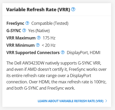

Does anyone know whether there is a downside to using this monitor with a Radeon 6900 XT?
I need to upgrade my GPU for this monitor and it seems that this GPU offers the best price/performance at the moment for this kind of resolution.
Does this monitor running Freesync have more input lag than running it with G-Sync?
It should work according to RTINGS - am I overlooking anything?
FreeSync and "G-SYNC Compatible" is identical at the signal layer, as they are both the respective AMD/NVIDIA certifications of generic VESA Adaptive-Sync. So I would presume no difference.
Thanks for your reply. Does this also work 100% the other way round?
In this case we have gsync native and freesync compatible.

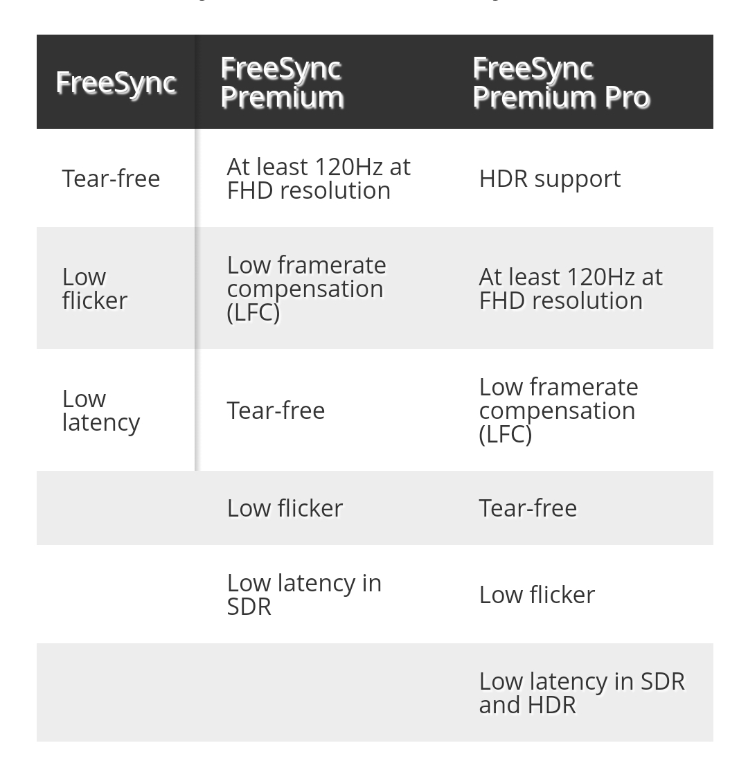

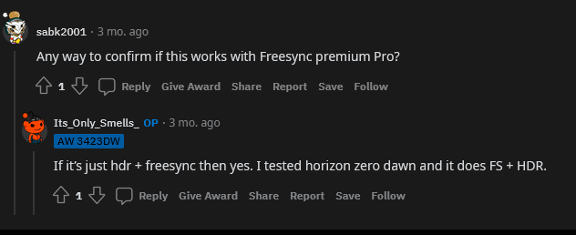

This person confirmed hdr+fs works, but do the low latency features etc. of fs premium pro also work?
Today, things have changed somewhat...
The premium features of G-SYNC and FreeSync are often specific to each vendor. Past G-SYNC native monitors could never work with FreeSync, but this is no longer true -- G-SYNC native chipped monitors of certain new monitor models now work with FreeSync on AMD cards...
G-SYNC native used to be fully incompatible with AMD cards, but this kind of changed in newer models of monitors with newer GPUs -- where several G-SYNC native models works in FreeSync compatible mode that works with AMD. So it's not as simple as it used to be to explain G-SYNC and FreeSync cross-compatibility. They are now more compatible with each other than they used to be, but not universally.
It's best when the monitor manufacturer sends the monitor to both NVIDIA and AMD to get certified by both, then you're assured of performance both ways -- premium G-SYNC and premium FreeSync in the same model is now possible if the monitor manufacturer pays both NVIDIA and AMD for all that extra work. However, this is not available in all models (Premium FreeSync may be some less-good G-SYNC Compatible mode, and one of the better G-SYNC / G-SYNC Ultimate certifications may provide some less-good FreeSync mode).
So it's a "depends on the model" thing nowadays. Look closely at the spec sheet and verify compatibility -- it may be bidirectional premium compatibility, or it might be premium/ultimate/enhanced only on one or other.
