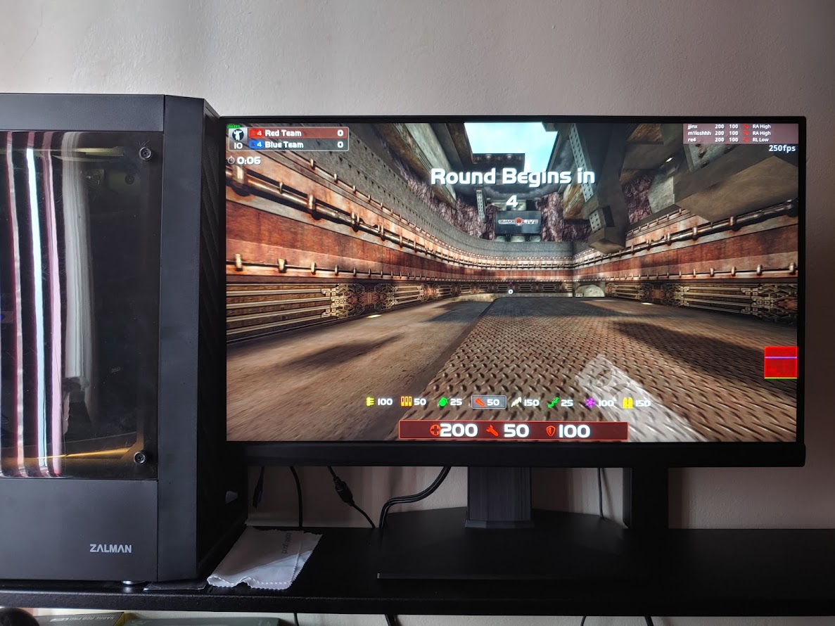

I'm about to get this monitor, I like to play multiplayer cs:go and singleplayer FPS games, my previous monitor is benq xl2430t 144hz, is a garbage compared to nowadays...
Update on 05.03.2022: Finaly got it, 0 scratch, used, for 225! absolutely enjoying it in FPS games @240hz + Displayport 1.4 cable (even though monitor supports only 1.2), this thing is a beast, destroys my benq tn with 144hz, 10 out of 10 B-) Just need a bit more tuning, and read this forum once again for the optimal settings, so happy i found this forum

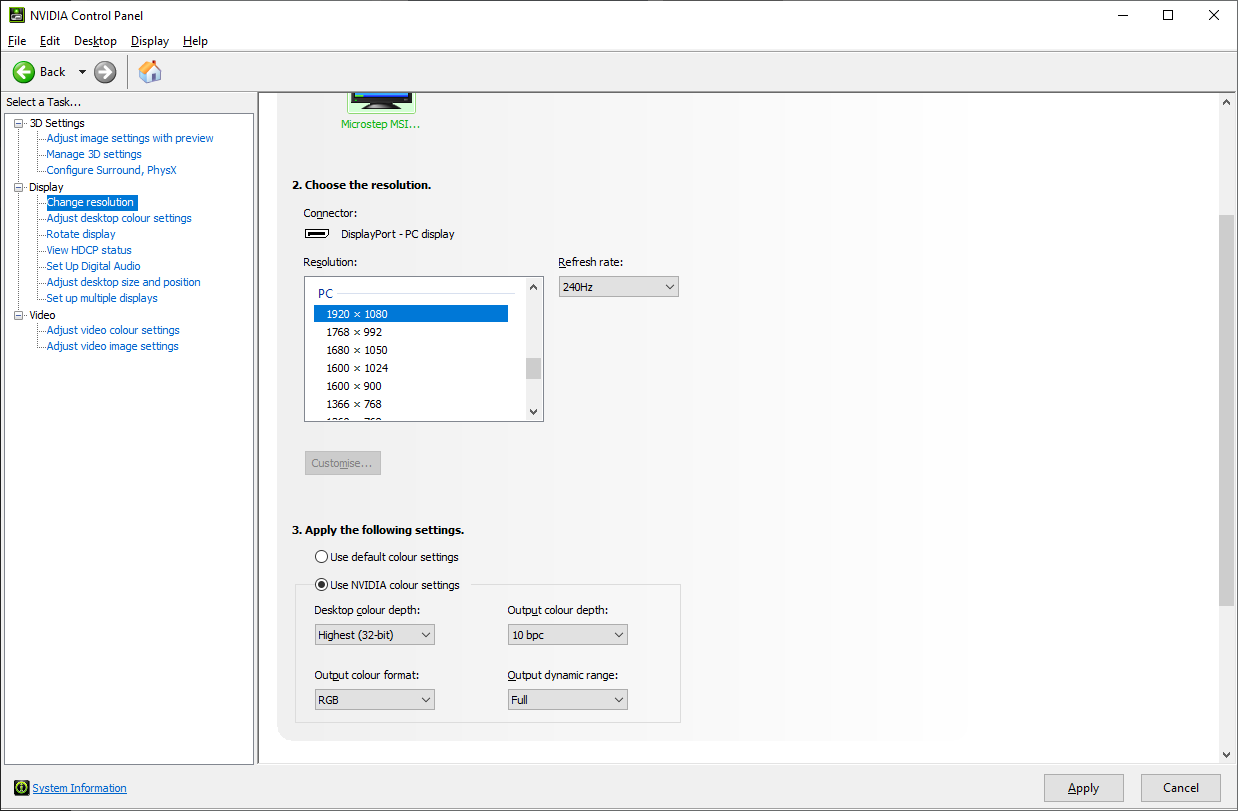

who could not achieve 10bit + 240(native), for you.
you just need to find cru 1.4.1, run reset-all.exe => restart.exe
then we do as described above. I'll just copy.
1/OpenCRU.exe
2/ Select the MSI MAG251RX (Active) monitor
3/ At the very bottom, clic on "Delete" (Extension blocks box)
4/ Clic on add (on the same Extension blocks box of course)
A new window opens
5/ Under Detailed resolution clic on Add (do not touch the Type : CEA-861 thing)
A new window opens
6/ Select Timing : Automatic LCD Native
7/ Change the frequency refresh rate to : 240.000

If you delete the extansion blocks in CRU - so you dont have any Data blocks unter Extension Block and just add the resolution with 240HZ, you can select 10 bit color - make sure you reset and restart via CRU before changing settings.Okeydoke wrote: ↑21 Jul 2020, 22:41@RLCSContender or anyone else that might know,
When I make the custom 1920x1080 resolution at 240hz in CRU so that it gets designated as "native," I lose the option to select 10 bit color, only 8 bit is available in the dropdown. I reverted back to the stock settings with the non native regular 1920x1080 at 240hz that it came with and the option for 10 bit is back. Am I missing something or doing something wrong?
Are we left with the choice of slightly less blurry and less input lag at 8 bit, or 10 bit with the extra blur and input lag caused by GPU scaling (because its a non native resolution)?
Thanks for any help. First time poster.
