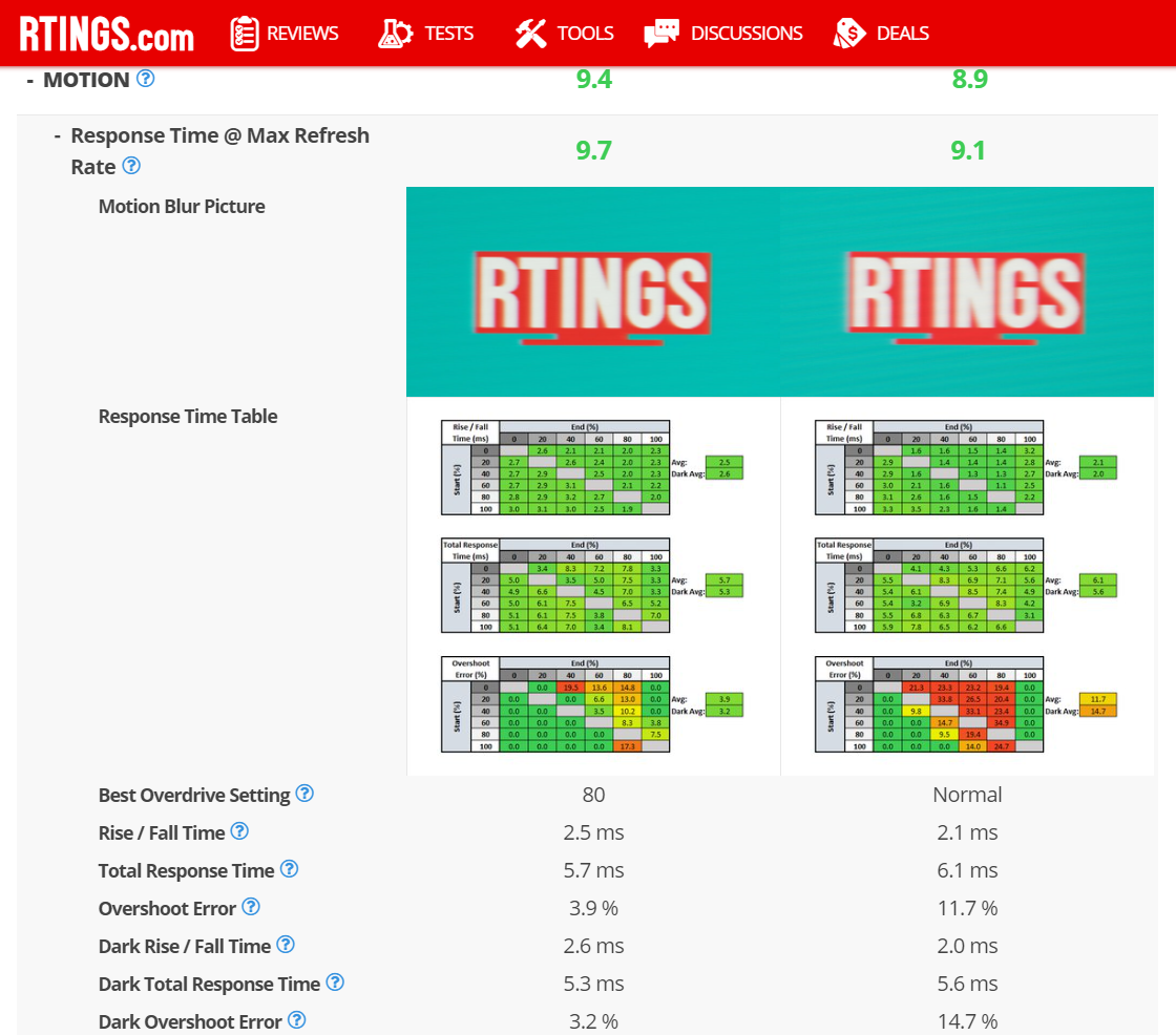

Q83Ia7ta
Posts: 761
Joined: 18 Dec 2013, 09:29
Re: Official Asus ROG Swift 360Hz PG259QN Owners Thread
Post by Q83Ia7ta » 22 Nov 2020, 22:22
Glad rtings made a review. Difference with VG279QM is minimal and some characteristics like quality of overdrive (overshoot) is better by VG279QM.
btw VG259QM is worse than VG279QM by rtings review.
VG279QM on the left, PG279QN on the right
source: https://www.rtings.com/monitor/tools/co ... 9768/17390
