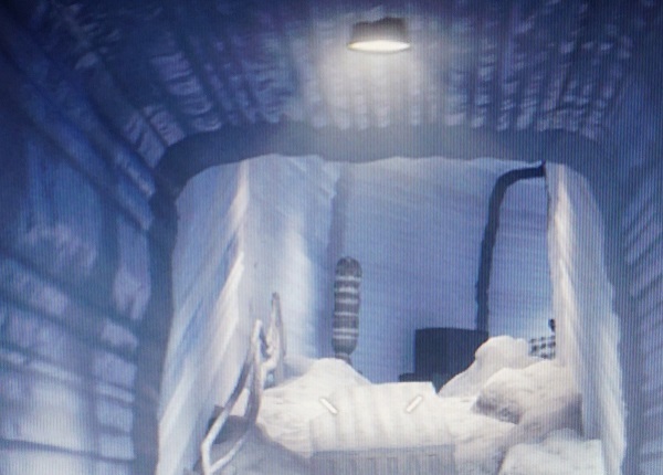

Blaskotron wrote:Do any owners notice any kind of vertical line texturing during movement? Sometimes called pixel inversion.
I returned my PG278Q due to this issue but it seems to be a normal artifact with that panel.
This is likely the same panel as the upcoming Acer and Asus 240hz monitors so would be good to know whether I should avoid all three.
i did and its very annoying, but hard to catch on camera because how feint those lines are. they looks like this (but in this photo i'm not sure if it is not just pixel grid).
i will try to make photo of them.

If its while moving only then its the inversion I'm talking about. If its not moving then its just the pixel grid.
This is an example from a review of a Dell S2716DG.

Yep, it's a typical inversion pattern (...it helps prevents buildup of static voltages in the LCD, and prevents burn-in on LCD...) which has a side effect of creating a faint griddy or checkerboard/cross-hatch sheen on an image. It's sometimes easier to see during strobing/3D usage. It can also vary in visibility during framerate changes in FreeSync/GSYNC too.
Some monitors have this very faint, and some monitors have it much more visible. (And occasionally if inversion is defective, it can look 10x worse than these images). These images appear to look normal (par for the course).
Most high-refresh-rate ultrafast-response TN monitors have this, while it's much more subdued on IPS.

Why it this effect has vertical lines on some monitors and checkerboard pattern on other? (vertical lines are more noticeable).
Can this be reason to return monitor? if constantly notice them because i sit pretty close to monitor.
If this thing is XL2540, it will 100% be on AOC, ACER, ASUS that use same LCD panel?
also one question, why in this test - http://www.testufo.com/#test=flicker&co ... height=240 i see solid almost colour on one monitor (with some kind of checkerboard pattern) and line hundreds on vertical lines (it looks like 1 line of pixel grid or more bright than 2 other) on XL2540? is it normal? when I turn override ON and boost up override value, first it goes violet/pink with with a lot of "noise" type pixels and if i continue to raise OD value it finally goes into solid grey colour.

iamwinner wrote:also one question, why in this test - http://www.testufo.com/#test=flicker&co ... height=240 i see solid almost colour on one monitor (with some kind of checkerboard pattern) and line hundreds on vertical lines (it looks like 1 line of pixel grid or more bright than 2 other) on XL2540? is it normal? when I turn override ON and boost up override value, first it goes violet/pink with with a lot of "noise" type pixels and if i continue to raise OD value it finally goes into solid grey colour.
As long as it is within visibility guidelines (i.e. equal to the average identical monitor) this is normal due to different inversion patterns on different LCDs. I also see hundreds of vertical lines on the ROG PG278Q too, but not on the XL2411Z.
If you see a very noticeable pattern during stationary images, that doesn't happen to other users, then that's more unusual.

is there any way to make them less noticeable?

You can't completely eliminate it, but you can attenuate it to an extent, sometimes to "too faint to be noticed" (but not on all screens). It varies a lot from monitor to monitor model, and even from panel run to panel run (e.g. AUO vs Samsung panels etc) as one monitor model can use panels from different manufacturers.
-- Adjust refresh rate (e.g. 120Hz vs 144Hz)
-- Turn off ULMB/LightBoost (pushing panels to limit can amplify the artifacts)
-- Warm up the screen first. If you're playing in a very cold room, give 30 minutes for warmup. (Artifacts won't comletely fade, but may be half as visible). This also helps ghosting, as we know cold LCDs can ghost more than warm LCDs (like forgetting a smartphone in your freezing car in the middle of winter).
-- Lastly, if you are using large "Vertical Total" tricks, try reducing Vertical Total (faster scanout can result in more intense inversion artifacts).
Inversion pattern differences on different panels, can mean some patterns are more intense on some screens for one kind of motion (vertical lines during flicker) a different sceen might be more intense for a different kind of motion (fine-checkerboard-pattern during smooth pans -- aka "Pixel Walk"). Screens that tend to produce certain kinds of inversion artifacts behave differently (i.e. needs different kinds of screen action occuring).
That's why inversion patterns at Lagom has multiple choices -- Lagom Pixel Walk Patterns since different panels use different techniques to do inversion (positive-vs-negative voltage balancing algorithms).
