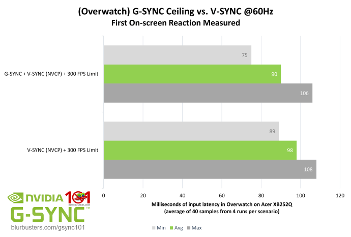

daninthemix wrote:I'm new to G-sync but am already noticing problems that may be covered in this thread. I have a 4K 60hz monitor, and I noticed in most games a minor stutter (as in the occasional hitch), but in some games it's very easy to reproduce. For instance Bioshock 2, I can load a particular save and simply move the camera left or right. Either there's stutter or there isn't. These are my findings:
G-sync ON + V-sync ON - STUTTER
G-sync OFF + V-sync ON - SMOOTH
G-sync ON + V-sync ON + NV Inspector 58fps frame-limit - SMOOTH
(note: doesn't matter whether the in-game V-sync option is on or off).
This is really annoying, because while just setting a global 58fps frame cap is easy enough, I also like to stream games to my big screen TV, either via Steam Link or Nvidia Shield, and that will obviously cause stutter on a 60hz TV! I'm damned if I do and damned if I don't. :(
(I also tried overclocking my screen, thinking that a 60fps cap at something like 64hz would work fine - but the monitor will not overclock at all, not even 1hz).
All the answers are in my G-SYNC 101 article:
http://www.blurbusters.com/gsync/gsync101/
If you don't want to drudge through the whole article, however, to sum up, if the framerate hits or exceeds the refresh rate, G-SYNC can no longer adjust the framerate to the refresh rate, and thus reverts to a V-SYNC state (G-SYNC + V-SYNC "On"), or V-SYNC OFF (G-SYNC + V-SYNC "Off"), which is why you need an FPS limit to keep it within its range.
And yes, I've noticed at lower refresh rates that G-SYNC can begin to stutter with G-SYNC + V-SYNC "On" once the framerate hits or exceeds the refresh rate. This is because while G-SYNC reverts to V-SYNC behavior here, there are still some differences between it and actual V-SYNC:
In this scenario, G-SYNC keeps bouncing in and out of its range (above the refresh rate rate it reverts to V-SYNC behavior and delays frame appearance, but in the next delivery cycle, the framerate may drop just below the refresh rate into the G-SYNC range and show the next frame without delay, repeat, causing the appearance of stutter; delayed frame, instant frame, instant frame, delayed frame, instant frame, etc), and at lower refresh rates, this process may simply be more apparent than at higher refresh rates.

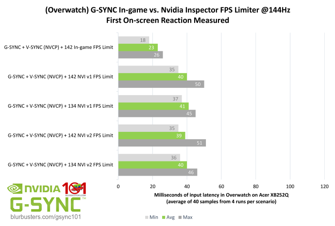

A also recommended the in-game or RTSS limiter. Nvidia Inspector adds a lot of latency with G-SYNC in particular:
TLDR; It's normal behavior, use an FPS limit in game's that the framerate can exceed 60 FPS at 4k when possible to keep G-SYNC within its working range.

daninthemix wrote:What confused me the most was how 'normal' (non G-sync) v-sync was butter smooth - so long as you stay at 60fps! I really do think Nvidia should do something about this.
V-SYNC may be "butter smooth" when sustained above 60 FPS at 60Hz, but it introduces anywhere from 2-6 frames of input lag in that scenario as well. G-SYNC fixes this within it's range, so stutter or no when hitting its ceiling, you don't want G-SYNC to revert to V-SYNC behavior, as it will also revert to these latency levels and you'll lose all benefits of the method anyway.
And there's nothing Nvidia can do to fix this issue; if G-SYNC can't adjust the refresh rate to the framerate, it can't work the way it is intended to, period. Only real solution is ever increasing refresh rate ceilings (240Hz, 480Hz, etc) paired with systems and games that can't exceed said refresh rates. In the meantime, a -2 or -3 FPS limit takes care of the "issue" quite easily.
