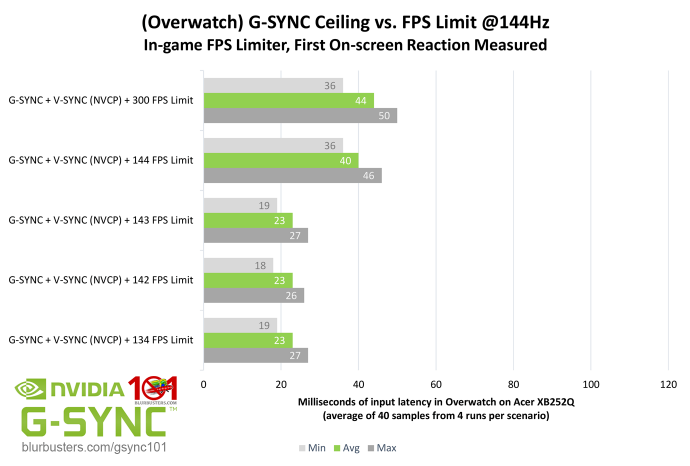

ViTosS wrote:Hey guys, I have a question, the optimal way for the less input lag at the moment is still G-Sync ON and V-Sync ON in NVCP, right? But why I have to set framerate limit in RTSS to 141fps (144hz) if the V-Sync ON at NVCP is already putting my FPS limit ingame to 144fps? Do I need RTSS limit too? Thank you!
The framerate limit is to keep G-SYNC within its range, and thus prevent it from hitting or exceeding the G-SYNC ceiling, at which point G-SYNC acts like V-SYNC and introduces several frames of delay.
I suggest using a -2 or -3 in-game framerate limit if the game contains a framerate limiter, and RTSS if not (in-game limiters provide lower latency than RTSS; complete details are already available in my article [which this thread is based on the discussion of], as are the answers to your original question).

ViTosS wrote:Thank you, but I didn't find in the article telling why to use RTSS together with V-Sync, but if the limit of G-Sync for my monitor is 144fps, I still don't get why I need the RTSS to limit what is already limited to 144fps (V-Sync ON).

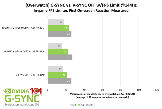

Simple, if you don't use a framerate limiter, and your framerate hits or exceeds your maximum refresh rate with G-SYNC, it reverts to V-SYNC input lag levels with G-SYNC + V-SYNC "On" (or starts to tear constantly with G-SYNC + V-SYNC "Off"):
At 144Hz or higher, G-SYNC can no longer adjust the refresh rate to the framerate, and thus it reverts to normal V-SYNC behavior. A framerate limit keeps it within the G-SYNC range.

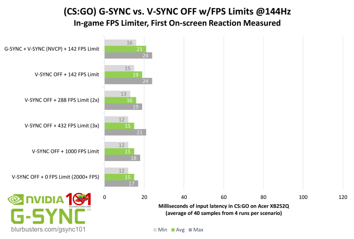

ViTosS wrote:Just one more question I promise, if I disable G-Sync and have my framerates all unlocked, I would have better input lag than when using G-Sync + V-Sync + RTSS limit? Because I really can't see the screen tearing with G-Sync being ON or OFF, so all I want is the less possible input lag.
G-SYNC + V-SYNC "Off" vs. G-SYNC + V-SYNC "On" at 144Hz:
At 144Hz, you're saving a maximum of 2ms with G-SYNC + V-SYNC "Off" over G-SYNC + V-SYNC "On," and that savings is directly reflected in the tearline. That's only for first reaction. If we measure at crosshair level, the input lag difference between the two methods is virtually zero.
If you don't care about tearing at all, then don't use G-SYNC. Simply disable G-SYNC and V-SYNC, and don't set an FPS limit with anything. If you can sustain very high framerates at 144Hz, you'll have the least input lag possible with that configuration:

Because V-SYNC doesn't stop frames from rendering above your refresh rate, it only limits delivery of frames to up to 144 times a second at 144Hz, so if your framerate exceeds that limit internally (this does not reflect in FPS counters), the buffers begin to get backed up, which delays delivery of frames on-screen, and thus adds extra input lag.
A framerate limit slightly below the refresh rate prevents this over-queuing of buffers, both for G-SYNC and standalone V-SYNC, as it, unlike V-SYNC, stops frames from rendering above that set limit.
