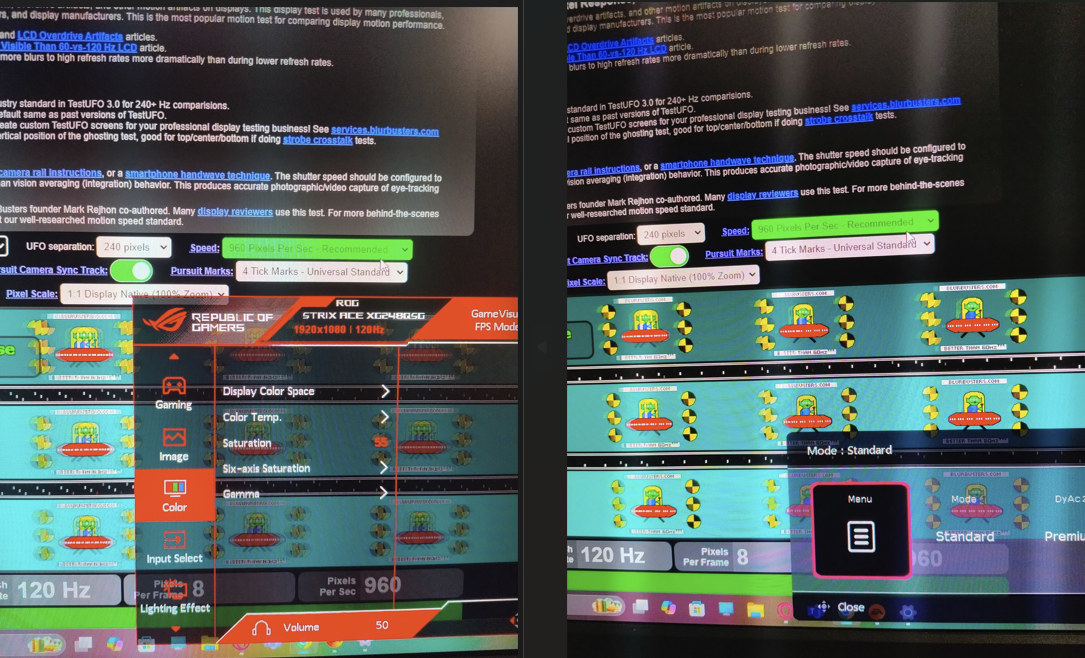

this 610hz asus is worse than pg248qp, and my 540hz zowie is just better, sure at around 360fps-610hz it isnt a crazy difference compared to the zowie, but at 120hz and 240hz the zowie buries it, the zowie looks like a clear image with some crosstalk, the asus looks like a blurry mess, its actually disturbing me lol. its so strange even though it has a rolling backlight it gets worse at lower than 360hz, like double imaging/crosstalk, from top to bottom, even the game visual modes alter the crosstalk, its wild, i can now start to see the zowie tax
TLDR- at 360hz-610hz its alright, i still think zowie looks clearer, and at lower than 360hz, its a no contest, i was expecting this to be like pg248qp but brighter and rolling scan, but asus slopped on elmb thats worse than ulmb, HAHA
Screenshot 2026-02-02 191900.png (1.21 MiB) Viewed 2600 times
The biggest issue with all non-Zowie “E-TN's” (540Hz) or “Rapid-TN's” (600–610Hz) is the use of KSF/PFS WLED backlight instead of a QD WLED backlight.
This results in severe red fringing.
MSIfanboy wrote: ↑
02 Feb 2026, 03:27
These monitors are all conceptually dependant on the refresh rate (vertical frequency) for the clarity you want to achieve.
The highest refresh rate setting is the lowest MPRT target option.
Everything below is subpar.
Hence why monitors with a adjustable pulse width setting (e.g. G-SYNC module ones or blurbusters utility ones such as the XL2566K, XG2431,...) are amazing at any refresh rate you set on them (excl. GSYNC ones since they're fixed refresh rate targets)
I don't know the exact duty cycle's that each implementation targets on these models though...
