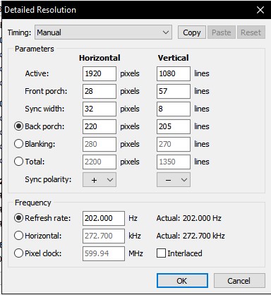

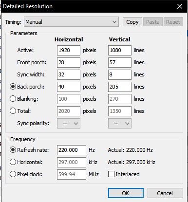

I've recently had success using a larger VT combined with RTSS scanline sync. I figured I'd share the highest VT I've been able to achieve which was 1360. I receive out of range error when using 1361VT and higher.
Using this custom resolution I am running the horizontal clock and pixel clock slightly higher than what my monitor was running at its highest refresh rate. Please do your research and use these values at your own risk.
Running RTSS with a scanline sync of -60 moved the tear line just above the top edge of my screen. I'm using Dyac+ premium and AMA premium which provided the smoothest motion clarity I've ever experienced while gaming.
Of course, when using these values you must make sure your frame rate = refresh rate. I encourage you to test your own values and share your results! Thank you Chief for making such thorough and helpful guides.

Ron wrote: ↑
08 Mar 2021, 10:37
Congratulations on achieving a Holy Grail of all these simultaneously:
- Lower-latency DyAc+ from Quick Frame Transport of Large Vertical Totals (using RTSS Scanline Sync negative indexes for End-of-VBI frame presentation, critical for lowering latency)
- Reduced-Crosstalk DyAc+ from Vertical Totals
- Easier tearline hiding
- Perfect jitter-free strobing (no DyAc-amplified microstutters)
- 240fps 240Hz RTSS Scanline Sync
This stuff is not easy to do, but you've got almost the Holy Grail! Most XL2540/XL2546 users have to reduce to 180-182Hz to get framerate=Hz, but pulling this off at max Hz is very hard. Especially due to Why is Refresh Rate Headroom Good For Strobing [Low-Hz Strobe on High-Hz-Capable LCD], but these BenQs, combined with some games, can do an acceptable job at framerate=Hz.
