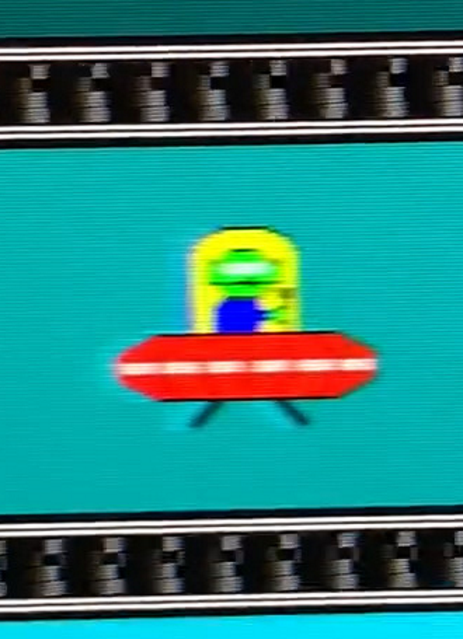

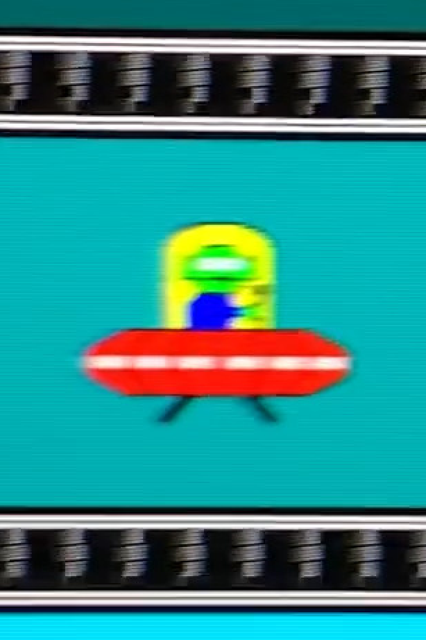

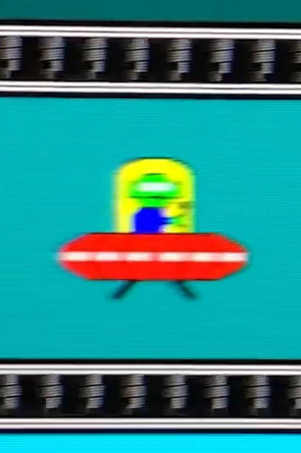

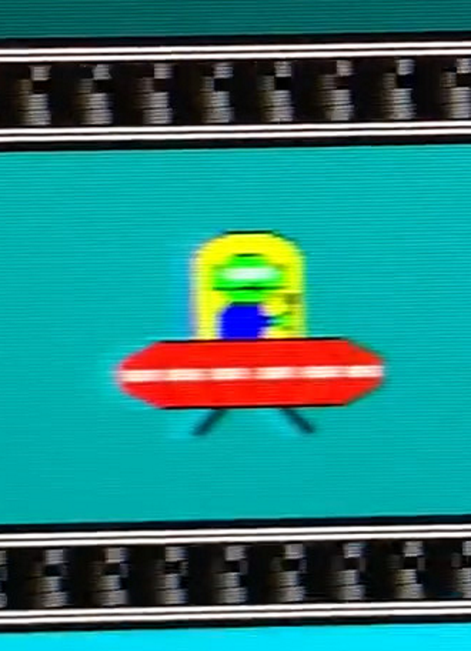

bleach wrote:
31 May 2020, 13:21
The pursuit I took isnt great, but it showcases just how terrible the overshoot is. 60 vs 80.
<Pursuit Camera Commentary>
I want to compliment you for the correct camera exposure -- not too underexposed, not too overexposed, and dynamic range seems balanced (I can tell from the top/center/bottom having different shades of cyan). That's as important as tracking accuracy. So, kudos for doing this attempt.
Excellent histogram chart, bleach -- a histogram-chart-look normally expected for a SLR camera (despite the imperfect but very adequate tracking of handwave accuracy). Your blacks are close to the correct black level, and your whites are close to the correct white level, almost spot-on without color gamut clipping (black clipping, white clipping). Very rare I see a great histogram in smartphone end-user pursuits. I don't know if your smartphone camera was very smart (what model?), or if you actually manually histogrammed it. Either way, smartphones are getting better & smarter.
Still, your post has been selected for a "Chief Blur Busters Zoomed Photo Crop" highlight -- which I give to end user pursuits meritworthy of further analysis :D
Here's selected crop-zooms for obsessive-analyst people in this threads (like me!). For the second one, vertical accuracy was definitely better because I see the "scanlines" of the horizontally-blurred screendoor effect on the second photo. Both have subpixel vertical accuracy, since the two horizontal white lines don't touch each other. And for horizontal accuracy is adequate (total amount of tickmark misalignment seems to be within +/- 1 pixel approximately) according to the verifiable photographed error margin. So your camera-blur error margin (relative to accurate eyetracking pursuit / accurate camera pursuit) is reasonably small.
My biggest nitpick is excessive camera compression (compression artifacts are very visible) -- compression artifacts are the biggest error margin in your photographs.
Your zoomed + cropped Tracefree 60, 270Hz, VG259QM
Your zoomed + cropped Tracefree 80, 270Hz, VG259QM
I wish more smartphones would support RAW capture or ultrahigh-bandwidth video capture (overkill bitrate) for video pursuits. Auto-burst-shoot apps can also be an adequate alternative to video too, if it unlocks a less-compressed pursuit.
For more user reading, see the Pursuit Camera Forum for instructions on how a forum member can do Android & iPhone handwave pursuits.

Posted: 31 May 2020, 14:30
by bleach
Chief Blur Buster wrote:
31 May 2020, 14:18
bleach wrote:
31 May 2020, 13:21
Iphone XS with fairly normal 1080p60fps video settings, selected best looking histogram stills from the video footage. I only took 4 videos, selected the 2 best looking ones.
EDIT yet again: these were taken at 270Hz refresh.
