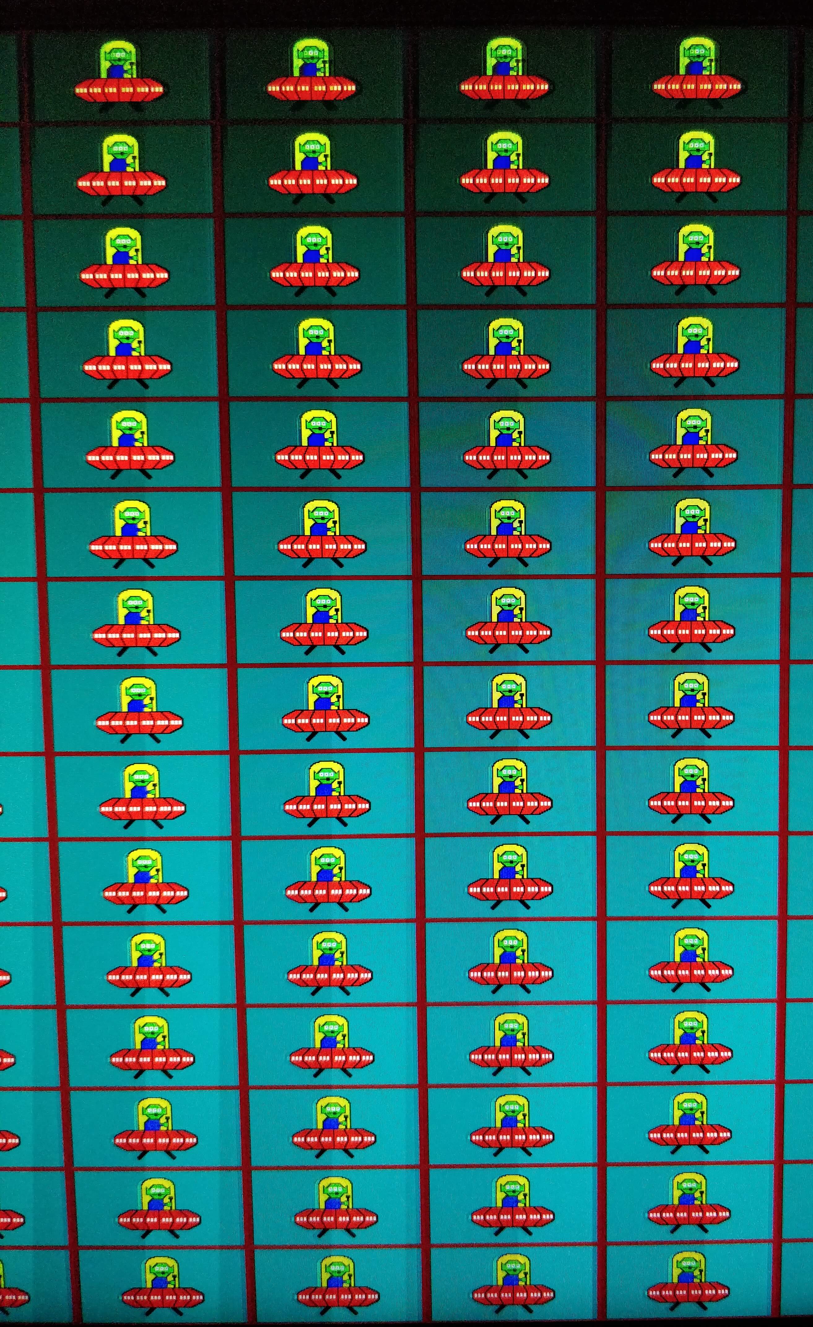

wow nice 1600 vt ! , any chance you could take pic/video of testUFO with this 180 hz / 1600 vt or 199 hz / 1600 vt?
if not maybe you could say in your opinion how is the crosstalk on top / bottom with this settings in the full-screen crosstalk test here:
https://www.testufo.com/crosstalk#photo ... &pursuit=0
if you put that on fullscreen do you see any big crosstalk on top/bottom area ?
because center area already looks almost perfect on this monitor with 240 hz / default VT in my opinion !
There's going to be no crosstalk band at all at the bottom, with "Area=0" in the service menu.
It won't look as flawless as 100hz and 120hz with VT 2250 (both of them can accept VT 2250, 144hz can accept VT 1650), but 180hz with VT 1600 will look nice. My 180hz VT on my XL2746S is 1500 because I got tired of testing VT's and dealing with the very problematic 151hz-175hz range (for some reason, you get slow syncs or black screens if you use a VT higher than 1400 in this specific range).

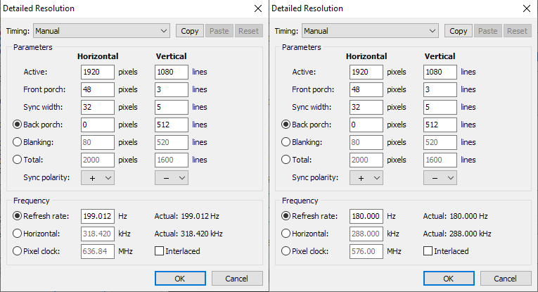

This is my 1600 vt setting for 199.012hz and 180hz.
the crosswalk test image is using my 180hz setting.
Remember to turn off free-sync before using these setting, otherwise black screen.
There will be a out of sync overlay click back on s-switch twice to remove.
Use Blurbuster strobe utility to tune the crosswalk area.
For overwatch I turn on v-sync on nvcp and v-sync off in-game. Using the in-game fps cap at 199fps to achieve low lag v-sync. Make sure your fps counter doesn't have three dots, should be only one dot.

Benq's 240hz timings are sort of whacked. I noticed this too. It causes strange stuttering on the monitor.
Try one of these. This 240hz is better: I tested it.
Use ToastyX Custom Resolution utility and edit the existing 240hz resolution in the extension block. Notice that Benq's defaults will show something weird like 239.795 hz or something awful...
1920x1080 @ 240hz:
Porch: 24,3
Sync: 32,5
Back: 25,152
Blanking: 81,160
Horizontal Total: 2001
Vertical Total:1240
Refresh rate: 240.000
Hor clock:297.601 kHz
Pixel clock: 595.50 MHz
If you can't maintain 240hz/240 FPS try a 180hz custom resolution:
180hz:
Porch: 48,3
Sync: 32,5
Back:80,412
Blanking:160,420
Horizontal Total: 2080
Vertical Total: 1500
Refresh: 180hz
Pixel clock: 561.60 mhz
Another person got 1600 Vertical Total to work at 180hz. I did not try this. (higher vertical totals will make blur reduction a bit brighter, and reduce the amount of strobe crosstalk you get with "Area=0" set in the Service menu. Also, high vertical totals also will make lower input lag with "Area=100" possible (up to 1 frame lower input lag) without having Strobe Crosstalk cover the entire bottom of the screen!
Note: DyAc Service Menu Area/Persistence (as well as OSD brightness %) values can be saved independently for both DyAc High and DyAc Premium and saved to the S-switch, and will be recalled separately for each setting!

BubbleFishHK wrote: ↑
23 Mar 2021, 09:40
