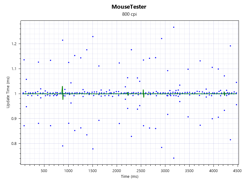

How is your frequency vs time looking ?
i just edited my post to answer your question - forgot it the first time around.
my results that i posted earlier and now are without any core affinity. assigning the cores usually improve my results when it comes to "periodical" jitter but not by much.
this periodical jitter mostly comes from nvidias drivers if i am correct in my testing.
interval vs time and frequency vs time will in my experince will almost always look 99% identical but here you go.

I wonder what I'm missing and my graphs are nowhere close to "perfect".
Damn that's kinda clean.

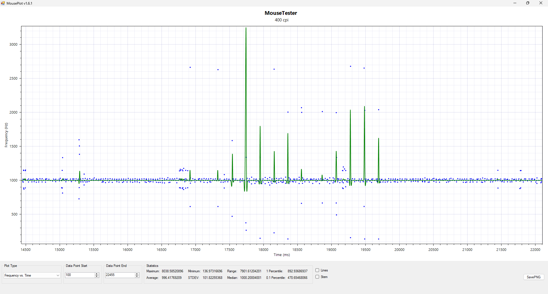

By the way this is what I get with nvidia driver enabled/disabled.
Enabled
Disabled

Is this suppose too be bad graph!? what?? this is a absoule beautiful graph... look at mine on windows 11 and new mouse i just bought with nordic and pixar 3950:
