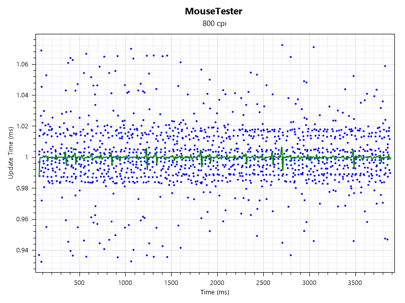

By the way this is what I get with nvidia driver enabled/disabled.
Enabled
Disabled

Is this suppose too be bad graph!? what?? this is a absoule beautiful graph... look at mine on windows 11 and new mouse i just bought with nordic and pixar 3950:
