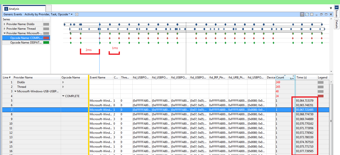

Tonight (over the past 3-4 hours) I rigged-up my Windows 7 laptop from 2010, which has only USB 2.0 ports and (after much fiddling with xperf and logman) I was able to repeat the combined ETW and hardware USB trace as on my other affected machines. Remember that this laptop does not exhibit the temperamental "floaty" mouse problem...
...and the ETW trace of USB URB completions shows the exact same 2ms gaps between groups of 9 events.
That is not what I wanted to see. This tells me that I'm likely chasing a red-herring - or (hopefully!) this indicates problems with my testing methodology which I hope I'll be able to identify and resolve. I'm hoping it's something as simple (and stupid) as me using the wrong sleep/wait technique in my Arduino code.
I'm still convinced that the actual problem ("floaty" cursors) can be quantified using these low-level traces - and by consistently reproducing the same inputs and comparing the actual cursor movements on-screen I'll be able to understand why it "feels" different.
Below is a screenshot of the ETW trace in Windows 7's WPA, showing the same 1ms+2ms gaps between reports.
WPA screenshot showing 2ms gaps argh - 2.png (73.04 KiB) Viewed 9477 times
I"m going to sleep-on-it for a while. I'm kinda bummed-out right now.

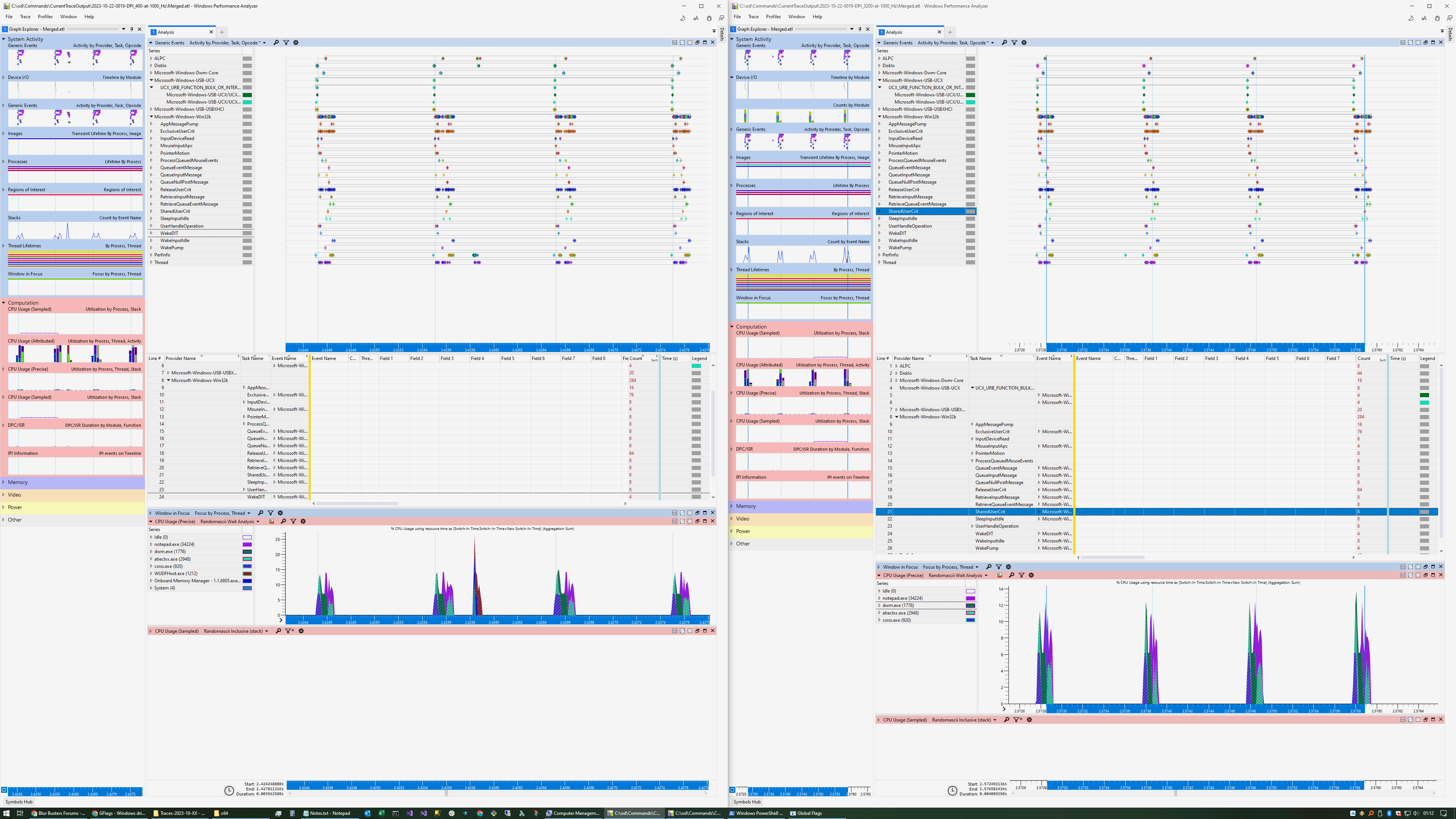

I'm currently having trouble getting my (brand new...) Logitech G502 X to consistently switch between its DPI settings, and when using the Logitech OMM (Onboard Memory Manager) program it doesn't seem to have any effect (as-in, my mouse pointer movement felt roughly the same even when I set it to 400dpi vs. 3200dpi).
But even-so, I did do a software-only (ETW) trace of kernel and user-mode events and looked at the data in-detail and again, saw no difference when I moved my mouse sufficiently fast over my mousepad (just moving it back-and-forth rapidly about 3-4cm total displacement)
400dpi on the left, 3200dpi on the right:
400dpi vs 3200dpi.png (588.71 KiB) Viewed 9238 times
Ultimately, the data/information in the screenshot above isn't particularly interesting from a troubleshooting perspective, all it does is confirm that (my mouse, at least) will report at 1000Hz at both 400dpi and 3200dpi - which is what I expected.
I haven't looked at this in detail too much, and ETW/software traces are heavily dependent on the the system's own timekeeping so this data alone won't be too useful without an independent timing source (such as the one used by a hardware USB trace from my Beagle), and the USB events don't seem to include any of the raw HID report data (despite using the "FullDataBusTrace" keyword) so I can't see the raw traffic (which is what we both wanted to see, sorry!).
But don't worry, I will repeat a comparison of different DPI settings (and with a hardware USB trace) once I've resolved the other known problems with my data-collection methodology.
What is interesting is that the traces show there's some disk activity happening with each mouse event - but it could be because I was recording the trace to-disk (rather than keeping it in-memory). Also, after I made the traces I learned that I need to use a different trace-provider to get CPU power information (i.e. C-states, etc) so I'll include that next time.
The unsettling things about this whole adventure is that the more I learn (about how USB, Windows, profiling, and computer hardware in general) the more uncertainty and questions I have, instead of answers, argh :cry:

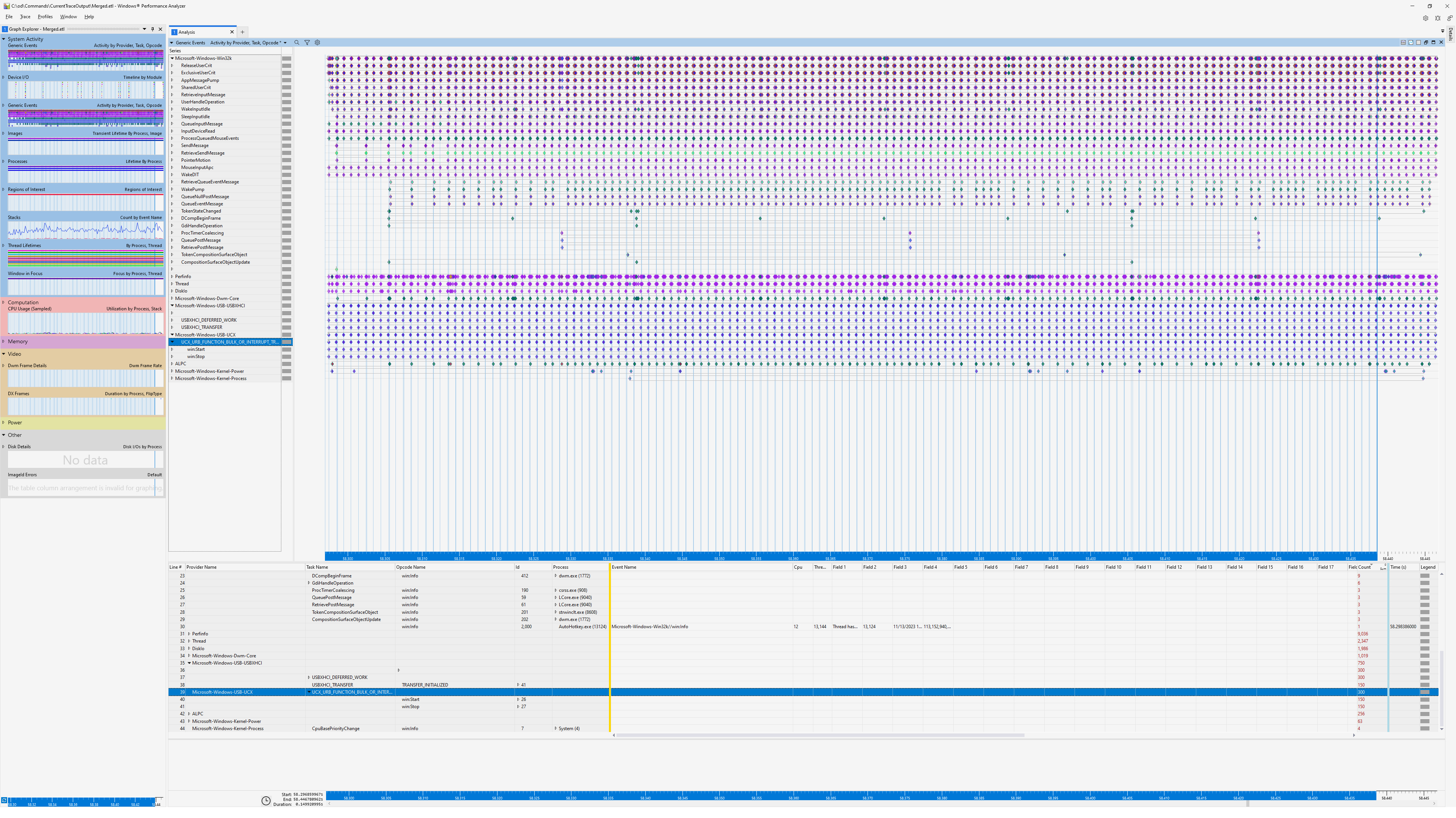

Some real progress this time: I was able to confirm the 2ms gaps in the traces (and the extra SOF packets in the USB trace) were caused by that timing bug in my Ardunino program - I rewrote it to use near-microsecond-level timers without any snapping to the nearest milisecond (nor USB microframe) and now the ETW trace shows consistent 1ms between updates.
Screenshot proof: no more gaps or grouping of events.
2023-11-14 - woo smooth no clumping - so now we can quantify the floaty feeling.png
2023-11-14 - woo smooth no clumping - so now we can quantify the floaty feeling.png (1.06 MiB) Viewed 7914 times
Now I'll need to simply gather more data and compare the exact differences between raw HID input values (which can now be consistently replayed), the resultant Win32 WM_INPUT messages (which should be 1:1 with the HID reports), and then finding out why the same inputs result in very different mouse movement behaviour based on how much my computer dislikes me today.
