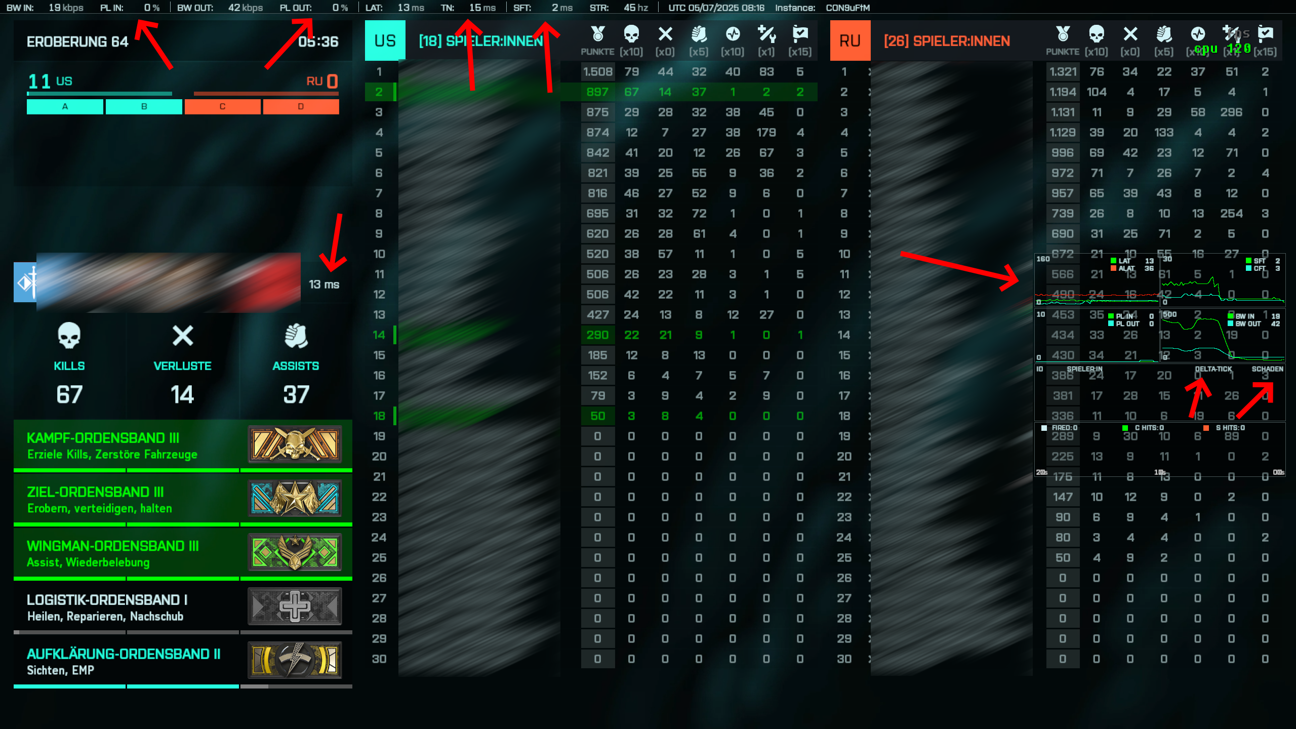

Which the OP doesn't, as he's enabled the game's diagnostic overlays, recorded the gameplay and looked at it afterwards, not spotting any packet loss. This isn't happening for him.

A game's diagnostic overlay showing 0% loss, normal and stable ping with very little jitter literally is the exact opposite of a fault of the ISP. If anything, it is 100% evidence of the ISP not being at fault.

1.) I enabled all the options in BF2042 to make problems visible, but everything looks normal.
