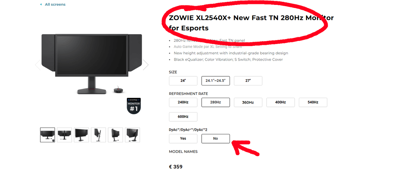

I just reread this section, since I'm going to try out some new TN monitors in the coming weeks (even though I've already tried three OLEDs since then).
So, can the XL2540X+ really do strobing?
I mean, I just looked at/compared the model numbers, the price, and the logic behind it all, and it doesn't make any sense (to me). I mean, we have:
- XL2540 - 240Hz (older, discontinued, no strobing version)
- XL2546K - 240Hz (older, discontinued)
- XL2540K - 240Hz (exact same panel as 46K but without extra accessories??)
- XL2546X - 240Hz (discontinued, probably due to the high dead pixel rate report? idk.)
- XL2540X+ - 280Hz (exact same panel as 46X+ but without accessories?)
- XL2546X+ - 280Hz
(the same as the one above but costs €141 more)
Now the big question:
Does the XL2540X+ are a XL2540K with newer panel and +40hz more or it's a XL2540-like without strobing ?
I mean, the XL2540X+ cost 141€~ less because it does not have extra accessories ? or it have slightly less performance (both strobing/G2G)
Edit: I just noticed that on the Zowie website, they claim that the XL2540X+ does not have strobing (DyAc).
BUT, on this video: https://www.youtube.com/watch?v=DAEUb-UHGJA, it apparently have accessories and strobing, wtf.
