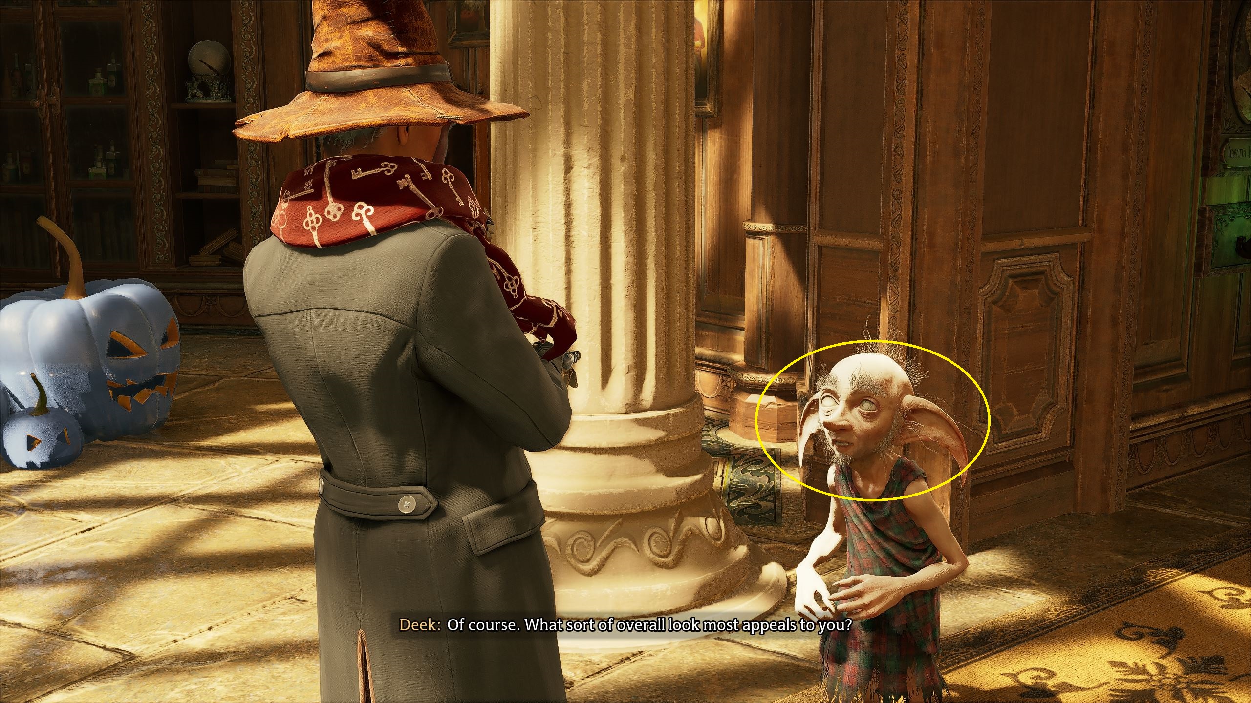

Post by zenki » 09 Jul 2026, 02:54
Anyone can help?
Didn't have the issue with other monitor.
Specs:
win10 21h2, rtx5070, acer XB273U F5 v1.1.8
