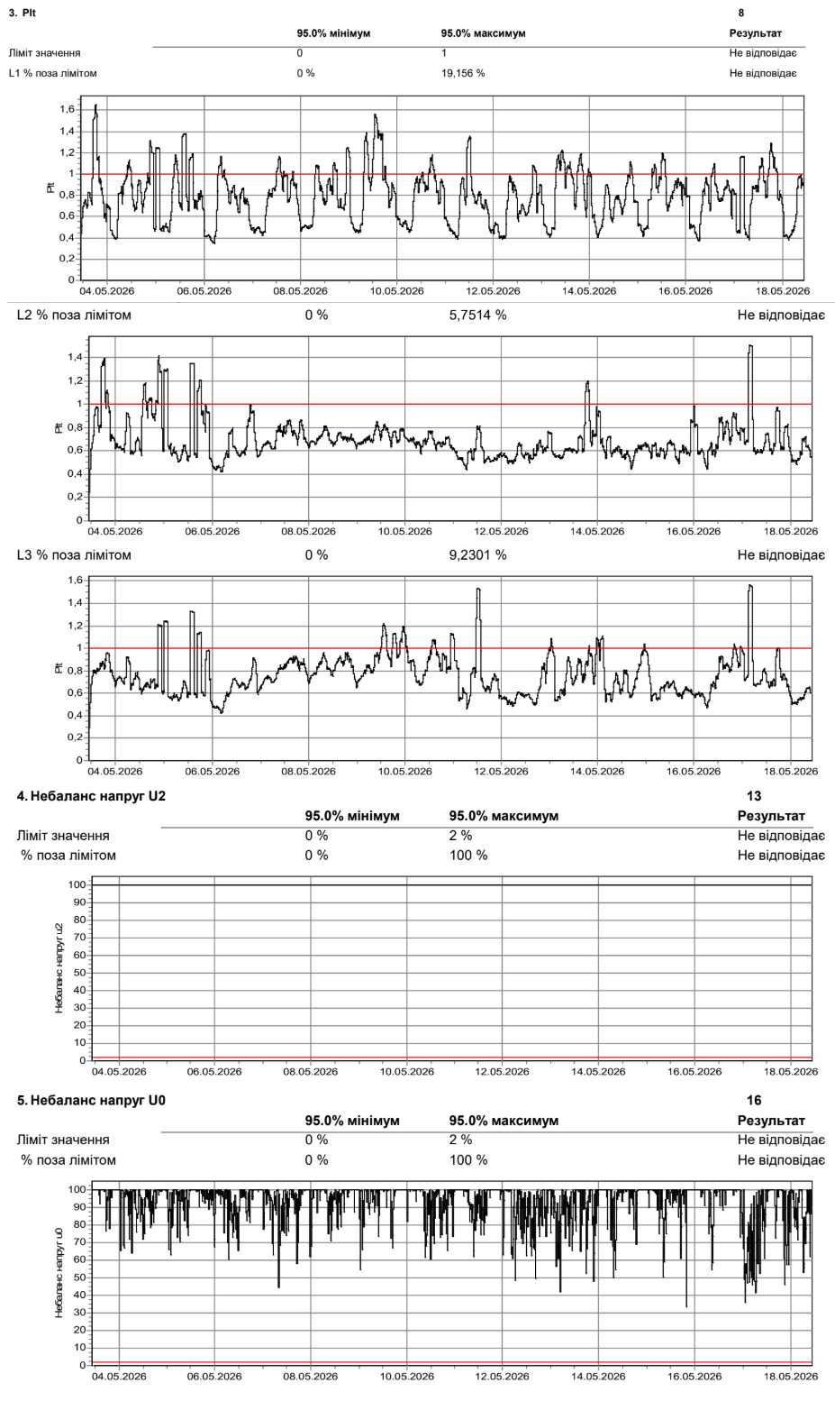

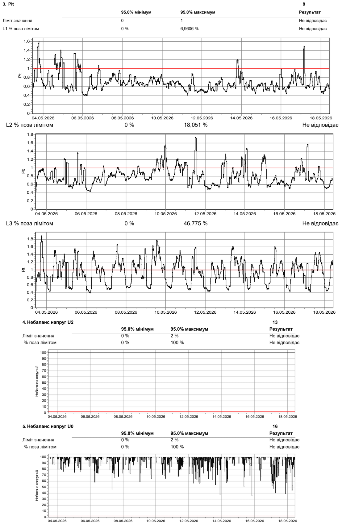

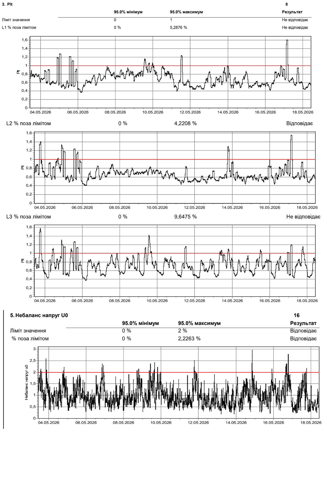

Have you been able to identify what type of power quality issue is affecting the 0.4 kV overhead distribution line?
If the problem is on a line connected to that overhead network, then the affected area is much larger than I expected.
It sounds like you believe the issue originates upstream of the building's electrical system, somewhere in the power distribution network before the electricity even enters the building.
That's a very interesting theory.

I ended up reaching almost the same conclusion two years ago. I ruled out hardware and software and RF noise. The only factor that consistently remained was the electrical environment.
I'm currently working with my power company to locate the source. So far we've confirmed that my 0.4 kV overhead line already has documented power quality issues, and they're once again logging the entire line.
PEN is one of my main suspects, but I can't honestly say it's the cause yet. At this point it's only a guess.
I'm also trying to find an independent electrical laboratory. But in those 2 years, I didn't really find anyone who had equipment or knowledge. I'll try to call 2 labs that I have found recently and see what they say.

Something has already been identified.
The distribution company installed three power quality analyzers simultaneously: at the 0.4 kV transformer, in the middle of the overhead line, and at the end of the line near my connection.
According to their own report:
Long-term flicker (Plt) exceeded the standard at all three measurement points.
The flicker generally increased toward the end of the line.
A measurable voltage drop was observed along the line.
The measurements also showed phase unbalance on the downstream part of the line.
Based on these measurements, the utility concluded that the transformer itself is unlikely to be the primary source of the problem because similar disturbances were recorded along the entire feeder. While the effect becomes more pronounced toward the end of the overhead line. Since the transformer was replaced. And it didn't fix anything.
At the moment, they believe the disturbances originate somewhere on the 0.4 kV overhead distribution feeder downstream of the transformer, although they have not identified the exact source.
The overhead line has not yet been transferred to the utility's ownership, which has significantly delayed the investigation.
So yes, at this point the evidence suggests the issue originates somewhere upstream of my house, before the electricity enters the building, rather than inside my house.
0.4 kV Transformer (EVM PQ3+):
Frequency (Frequency Compliance) - Compliant / Within limits
RMS Voltage (Voltage Magnitude) - Compliant / Within limits
Long-Term Flicker Severity (Plt) - Non-Compliant / Exceeds limits
Voltage Unbalance / Negative Sequence (u2) - Compliant / Within limits
Voltage Unbalance / Zero Sequence (u0) - Compliant / Within limits
Total Harmonic Distortion (THD U) - Compliant / Within limits
Voltage Harmonics - Compliant / Within limits
Air Overhead Line Pole No. 1 (First Overhead Support) (EVM PQ3+):
Voltage Unbalance / Negative Sequence (u2) - Non-Compliant / Exceeds limits
Voltage Unbalance / Zero Sequence (u0) - Non-Compliant / Exceeds limits
Air Overhead Line Pole No. 2 (Second Overhead Support) (EVM PQ3+):
Voltage Unbalance / Zero Sequence (u0)- Non-Compliant / Exceeds limits
These measurements were performed by the utility itself, not by me. The investigation is still ongoing because the exact source of the disturbances has not yet been identified.
Here I attached:
Info At the 0.4 kV transformer;
Info At Air Overhead Line Pole No. 1
Info At Air Overhead Line Pole No. 2
