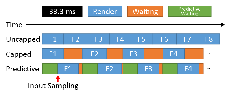

GeDoSaTo does this:
http://blog.metaclassofnil.com/?p=715
It only works for DX9 games.

RealNC wrote:GeDoSaTo does this:
Fantastic, it's already done. Like minds thinks alike!
Predictive frame capping. Intentional delays, called "predictive waiting", to reduce lag.
Diagram from that page:
In theory, graphics drivers can be made to do this.
NVIDIA already does frametime prediction for many things -- e.g. microstutter reduction for SLI, variable overdrive for GSYNC, etc. In theory, that logic can be borrowed to create a low-latency VSYNC ON, but I suppose it could hurt their GSYNC monitor sales...
So, third party it is. Can we do this again for modern games to have the world's lowest-lag-possible VSYNC ON? It would be great for ULMB-lovers, LightBoost-lovers, etc -- since strobe modes look better with synchronized framerates. Maybe even possible via an extra layer, filter driver, or other third party utility that stands in front of the graphics drivers to insert forced delays.
