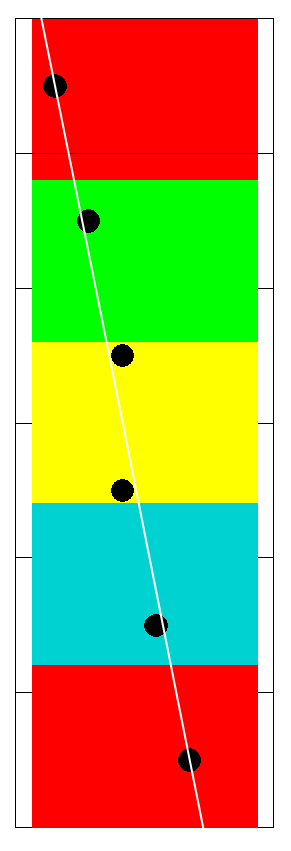

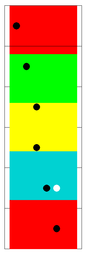

I drew a very simple diagram, which is ideal 120 FPS @ 144 HZ. So, the stutter occurs in the refresh cycle 5#?

Post by Chief Blur Buster » 10 Mar 2018, 11:44
No. Divergence is 3rd and 4th, so the stutter is on the 4th object.
(Good VSYNC OFF diagram though -- it is very accurate diagram otherwise for a VSYNC OFF example -- where the black lines are refresh cycles, and the colored boundaries are VSYNC OFF tearlines).
Draw a straight line through all balls.
For a specific pixel in a refresh cycle (i.e. in the same physical row of pixels, for horizontal eye tracking), that is your corresponding horizontal eye gaze position relative to time.
Stutters are for all balls that don't go on the straight line, and jumps over the line.
So between the 3rd and 4th ball is the stutter, and you see it right at the moment of the 4th refresh cycle (4th ball).
Your ball is essentially "vibrating" centered on your moving gaze point.

So, simply really gotta remember that stutter are just simple Geometry 101 divergences away from a constant-moving eye-track gaze point. Easy once you understand the basic concept.
Definitely look at the YouTube video, it will explain why stutters and display motion blur (sample-and-hold) is exactly the same kind of "keep-sync-with-eye-tracking" mathematics challenge. By simply visualizing stutter & blur from the eye-tracking point of view, it's much easier to figure out if you are good enough at math & geometry.
For scanout diagrams and determining stutter, you simply draw a straight line, and now you've turned a scanout diagram into an eye track diagram. (At least for determining stutter in the horizontal dimension, anyway -- but that's simply due to the vertical layout of scanout diagrams on BlurBusters).
