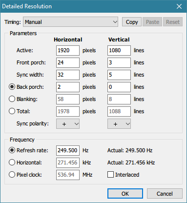

Wow 280Hz, very nice. I'm a little confused reading that.. sounds like there's a little more to it than simply setting a preset. Also I wonder if it would work for XL2720Z. I do have my XL2720Z pushed to the (known) limit of 250Hz which I have been using for a while (after deciding to push more than 220Hz). When limiting the game engine FPS from 144 to 250 FPS, there is a noticeable difference, so it's a nice step up. The image quality and colour is definitely not something I'd recommend for desktop use, only for FPS games:
