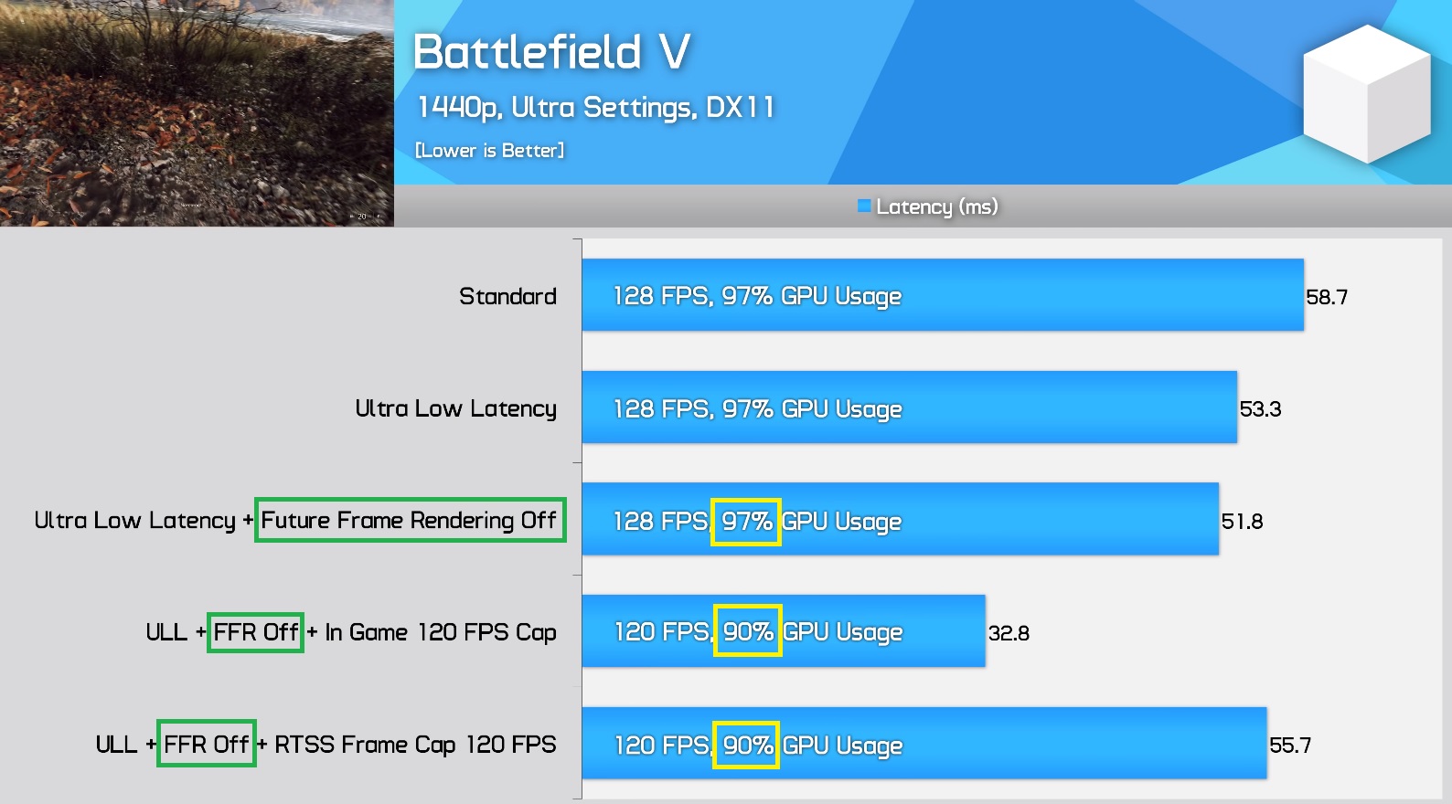

Post by Vega » 02 Oct 2019, 04:07
People are confusing two things. The significance of the Battlenonsense video is that excluding every other variable, simply having GPU usage below 95% in of itself reduced input lag significantly. No other testing before that revealed that info.
Ton's of people play with an FPS cap that keeps their VRR under their monitors maximum refresh rate YET still 99% GPU utilization. That means you will still get the input lag penalty. Not only do you want to cap the FPS under the monitors max refresh rate to keep VRR active at all times, you want to cap it low enough that GPU utilization never goes above 95%.
At this point unless GPU manufacturers fix it, you ideally would want a FPS cap under the monitors max refresh AND a GPU utilization cap utility, which as far as I know doesn't exist.

In Battlenonsense's testing, using RTSS FPS cap was actually lower input lag than in-game FPS limit. I think Mark got the same results. This also makes sense since RTSS can FPS limit down to the third decimal digit now. In-game FPS caps cannot do that.
The way that I am going to keep the pipeline clean is to play the game, find what 99% of the frames max 95% GPU utilization and below FPS is below monitors refresh rate for G-Sync and RTSS cap at that.
If the CPU/GPU can handle above the monitors max refresh while keeping GPU load consistently below 95%, I'll just use the normal cap 140 FPS for 144 Hz monitors, 160 FPS for 165 Hz monitors, etc.

Vega wrote:In Battlenonsense's testing, using RTSS FPS cap was actually lower input lag than in-game FPS limit. I think Mark got the same results. This also makes sense since RTSS can FPS limit down to the third decimal digit now. In-game FPS caps cannot do that.
While there are exceptions (some in-game limiters just don't work properly), generally, it's actually the opposite, and (proper) in-game FPS limiters have less input lag than an RTSS FPS limit:
https://www.blurbusters.com/gsync/gsync ... ttings/11/
I also explain why in more detail in my Closing FAQ of the article:
Okay, so then why exactly do in-game FPS limiters have less input lag than external FPS limiters again?
In-game FPS limiters (G-SYNC or no G-SYNC) almost always have less input lag than external FPS limiters because they can set an average FPS target at the engine-level (and let frametime run free) during the actual calculation of new frames, whereas external limiters can only set a fixed frametime target, and only after new frames have been calculated by the engine.
With RTSS, framerate limiting via a frametime target means its limiter, while slightly higher latency, is steadier when directly compared to in-game limiters. This actually makes RTSS better suited to non-VRR (variable refresh rate) syncing methods, such as standalone V-SYNC, where steadier frametimes are vital in minimizing the occurrence of mismatched synchronization between the GPU and display below the refresh rate.
For G-SYNC however, with its frametime compensation mechanism (G-SYNC + V-SYNC “On”), and it’s ability to adjust the refresh rate to the framerate down to the decimal level, smaller frametime variances aren’t as important, and thus, an in-game limiter is typically recommended for the lowest input lag possible.
But yes, regarding some of your other previous comments here, with VRR, so long as the FPS can be sustained above it at all times, an appropriately set (preferably in-game) FPS limit that both prevents the framerate from exceeding the VRR range AND the GPU usage from maxing out, is required for the lowest input lag.
This addresses both system-induced and sync-induced input lag.
As for Battle(non)sense's OP video here, it was obviously only covering the former (he had VRR/V-SYNC OFF for all those tests).

I re-watched the Battlenonsense input lag videos. You are right, in-game FPS limit slightly less lag than RTSS FPS cap. Although he did hint that RTSS may keep a more consistent FPS and hence smoother appearing motion versus in-game FPS limiters.
