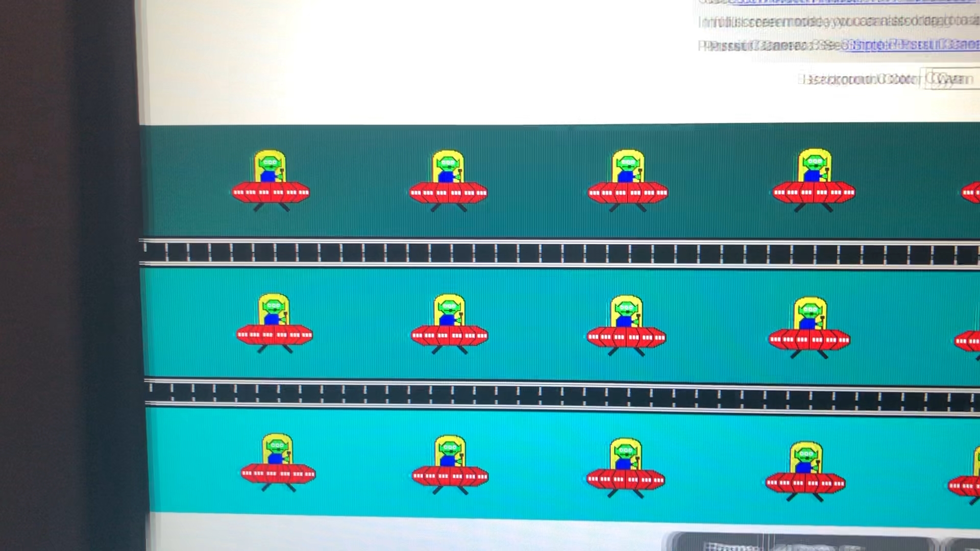

Thanks! I will have to give that a try. I might also find a download site that will host the uncompressed video file so people can download it and view it locally if they wish to see it.
BTW, do you have any idea if I could enable single strobing in that service menu? I'm not very familiar with BenQ service menus nor do I know enough to know what to look for.
Edit: Here's a snapshot image I took from the raw video file. It's a pretty good approximation of how it looks the entire time but in person I'd say it's even slightly cleaner than this. Like I said, I'm very impressed with the DyaC+ they built w/this new generation panel, even when gaming w/it on there's no discernible input lag hit.
Image taken from raw video file. In person it's even cleaner than this.
Imgur link for full image: https://imgur.com/5fdpFAQ
