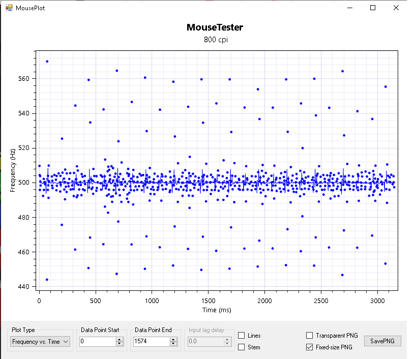

Why how would MSI affect internal polling rate of mouse? I use default, SATA+NVME are on high by default. Works best for me. I have highest user to process latency 100us in latmon!BTRY B 529th FA BN wrote: ↑26 Mar 2021, 16:17What are your MSI interrupt priorities for all your devices?empleat wrote: ↑26 Mar 2021, 13:11I use 500hz mouse/1000hz keyboard. I don't know if there would be some benefit to connect them via hub to 1 USB port. I heard hubs can cause lag, rather than help with it. I don't think I have most of these issues, you were describing like: IRQ conflicts. And I can't avoid Xhci unfortunately since no firewire port and new mobos have only Xhci driversProbably pointless to do this for me...
To recap: I have these spikes 15-25hz tho, but that doesn't seem that much. Even on different USB chipset, I tried connecting keyboard into USB 3.1 port - lower on my motherboard, didn't help at all - same results! This doesn't change if I use for USB 2 for both keyboard and mouse!

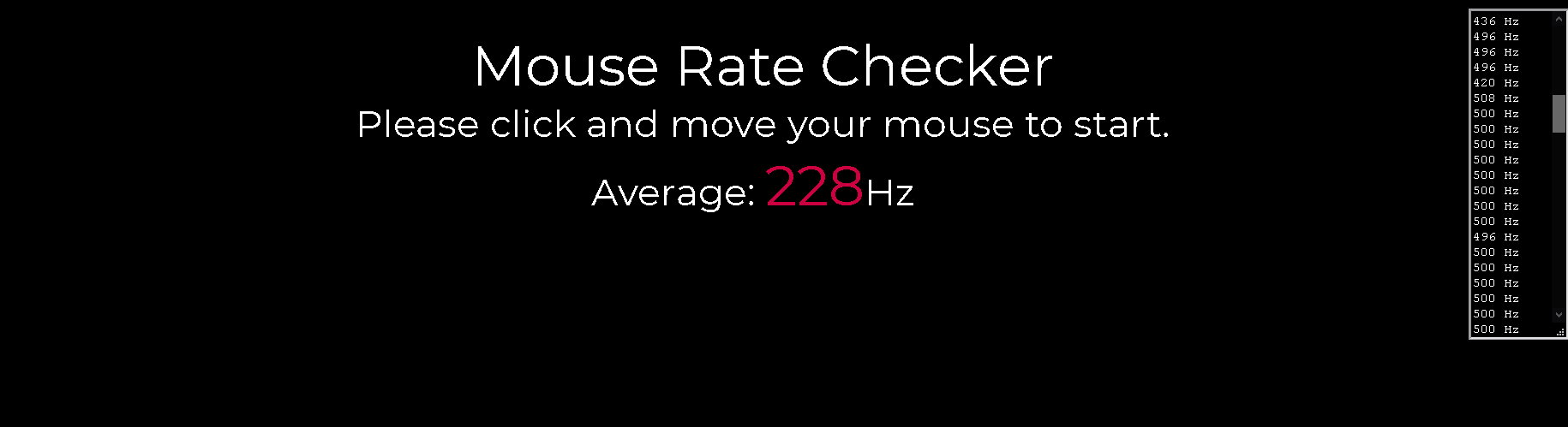

At least that's I assume what MouseTester measures under "Frequency vs Time" and not final. You have other category, which also shows polling rate: "Interval vs Time". It is confusing that the same thing is in 2 categories. And by final: I mean after it is handled by system (DPC latency) and timer resolution. Not sure, if this program has to wait on timer window, or can read data directly from a mouse driver. Because these things affect polling stability, if you miss timer resolution you will have to wait another e.g. 0.5-1ms, before game can use that! And DPC latency, before CPU handles DPC.

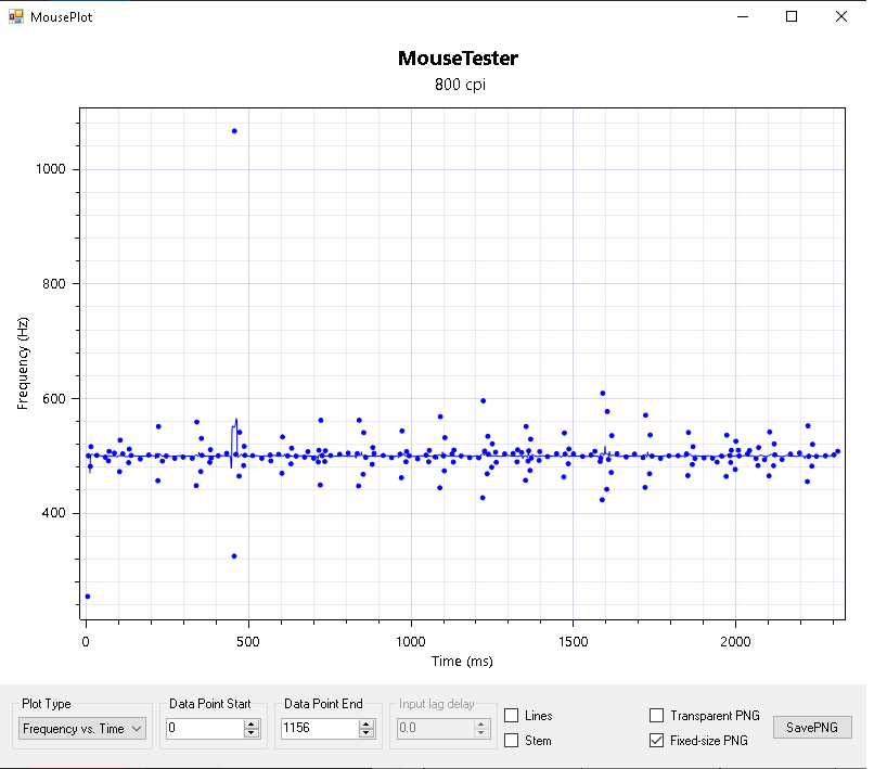

Hmm I did another test and now line is smooth except 1 place. Maybe I wasn't doing circles continuously fast enough, because my mousepad is worn out. I still don't understand all graphs in this program. In original thread is: that for polling rate stability you should take into account line and that's it. It is not explained there what exactly are line or dots in this case! I also don't know why dots are reaching 600hz. On Zowie test, I have only 506hz max. On mousetester thread for other type of measurement there was written: line is average, but it doesn't make sense - if I look on 3rd picture, as line is straight even if there is not equal amount of dots vertically at some place on both sides!
I was changing MouseDataQueueSize, it could be that! Third picture is when I put queue to 50, which should be default value. But picture from my previous post was with value 20. So it seems mousetester hz spikes were caused by this setting. What is strange, on Zowie tester: it is constantly 500hz in both tests. It never goes above 500hz and stays there during rapid movement. I Am starting to think MouseTester doesn't work!
Although look at this crap, on the first picture: it looks like mouse is overclocked at 560 and than downclocked to 440. Strange as hell. It is more consistent on 50 value for sure. If you lower value, it queue less data in buffer. But I still don't understand how this could affect polling rate... https://docs.microsoft.com/en-us/window ... ss-drivers
Logically, if it is gonna wait, there is gonna be more delay. So yes lowering Mouse driver buffer helps a lot with input lag, but it makes mouse less consistent. Maybe because you gonna notice more difference in polling rate. There is variation 2-4ms of delay at 500hz, depends how you hit timer resolution and timing before next fps starts to render. But I don't think this could affect mouse internal polling rate, doesn't make much sense. So it looks like MouseTester reports wrong, I don't know how it calculates polling rate...
Not to say you should rely on a single program. But I don't know anything else for testing polling rate stability, except that zowie tester! Maybe ADK? Not sure.
