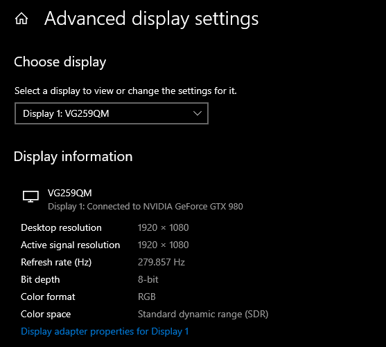

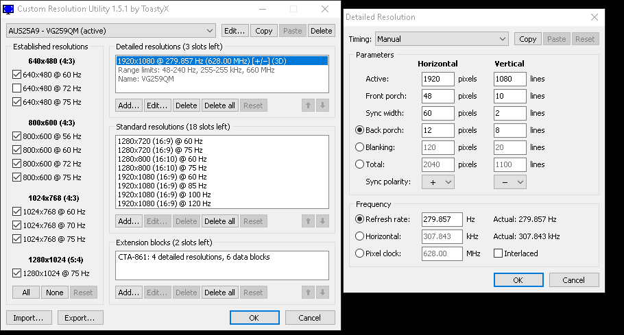

Hi guys, I have a problem with vg259qm.
My windows display settings showing 279.857hz.
and when I look at settings with cru, I see it is different from the default settings shared on the forum
