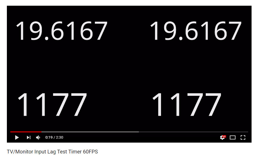

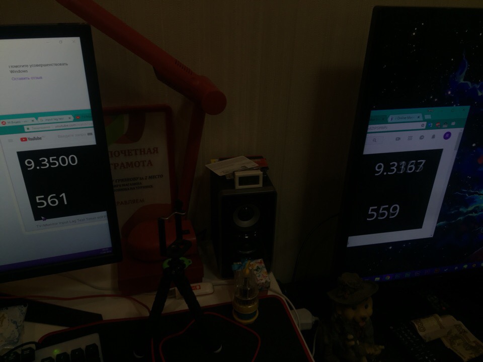

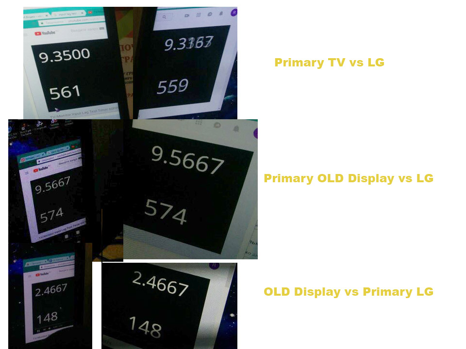

Today I got my monitor, I use to expand the screens (should be in this mode there should not be problems with the delay of the secondary display). I use a video on a YouTube with a timer, and I move the browser window in the middle of the displays, and I change the priority of the displays. I got an interesting result, the difference between the input lag between TV and LG is high, but there is no difference between my old display with 4 ms lag

from the site information https://overclockers.ru , I read the reviews of the monitors, iiyama x2377hds and benq xl2411t, according to the site, both monitors are the fastest ones (for input lag only) at that time , I do not feel the delay of the image, but maybe I'll notice the difference when I try another 240Hz monitor. I'm not a gamer, but I've used a CRT monitor for 14 years - it's a very sharp image in motion and a low input lag, and on an ordinary 60 Hz LCD monitor, a terrible blur even in the interface of windows, browser, etc. 240Hz and strobing is the salvation of my eyes, I have an old CRT monitor at work, I'll try to use it in the input delay test as a referencek2viper wrote:Why are you sure that your old display has low input lag as only 4ms?
