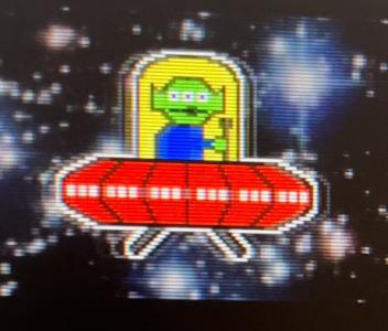

Update: XG2431 vs 25XV2Q
Did a comparision on my:
  • iPhone camera (iPhone 12 Pro Max, 4K, 60fps, HDR),
  • AOPEN 25XV2Q (390hz, TVR Extreme, AMD Freesync Premium Off),
  • ViewSonic XG2431 (240hz, PureXP Extreme, AMD Freesync Premium Off),
  • Mozilla Firefox on Windows 11: I plugged both monitors using DisplayPort and make the tested display the main display in Windows setting.
Results:
XG2431:
xg
xg
25XV2Q:
xv
xv
I am not an expert on the testing methodology of these pursuit-camera techniques, but if there's something wrong with my methodology please excuse the mistakes. I think I'll return the 390hz monitor.

Michael0121 wrote: ↑
02 Aug 2021, 19:17
Great comparison with out-of-box strobe tuning!
It appears you tested max-Hz strobe, which is a worst-case. The refresh rate headroom technique improves strobing further.
You actually can get even better quality strobing with a little tweaking too via Strobe Utility after breaking-in your panel.
1. Make sure to warm up your ViewSonic at least 60 minutes before testing strobe. LCD GtG is faster on warm panels.
2. Make sure you pursuit in full screen mode, because it automatically vertically centers the UFO.
3. Optionally, using www.testufo.com/ghosting is actually easier to hand-pursuit your smartphone on, if you decide to attempt hand-wave pursuit.
Strobe crosstalk photography can be done via stationary or via pursuit
A. For stationary, make sure you use 1/240sec camera exposure (1/Hz)
B. For pursuit, use 60fps video setting and dim your screen until you're able to see the sync track clearly while waving your smartphone (1/60sec exposure to capture 4 refresh cycles per camera exposure)
