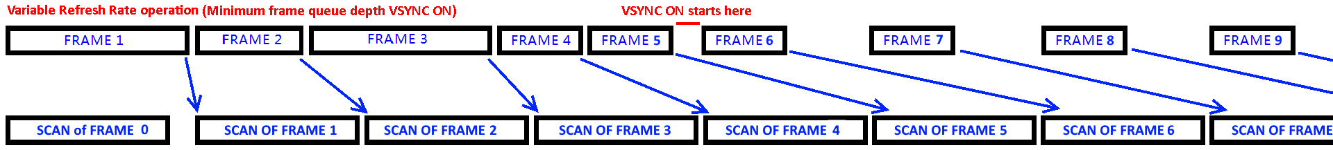

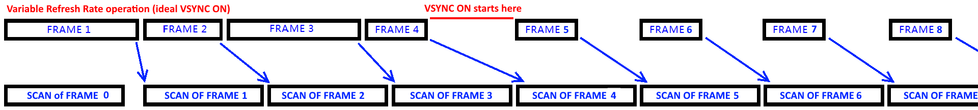

Post by KKNDT » 15 Mar 2018, 07:53
Does G-SYNC + V-SYNC ON behave like this if you don't give it a proper FPS limiter when FPS hits the Max HZ? Thanks.
G-SYNC V-SYNC ON.png (7.45 KiB) Viewed 8546 times
Posts: 12298
Post by Chief Blur Buster » 15 Mar 2018, 08:45
It can but usually worse: buffer pile up.
(When there's more framebuffer backpressure than in your diagram.)
Your diagram has only a fraction of a refresh buffer delay. Your situation sort of occurs more frequently with a cap actually: if a cap exists but is too close to refresh rate.
Without a cap - you will usually get more buffer pileup. Then you are almost permanently one or two frames ahead once you have the first moment of several consecutive "fast" frames -- until framerate slows down and the buffer pileup (VSYNC ON) disappears -- (and that makes it go back to GSYNC lag mechanics too)
That said, usually, frametimes usually don't continually fluctuate nearly that much of a percentage in adjacent frames, though - just momentarily (scene changes, loading assets, etc). The rest of the time, frametimes usually modulate smoothly, unless the game is poorly designed.
Two possible examples.
The first one is the best-case uncapped VRR + VSYNC ON scenario.
The second one is unfortunately common with many implementations, creating more lag.
Basically, a common behaviour of laggier 1-extra-frame queue version of uncapped VRR + VSYNC ON.
The longer the arrow, the more lag.
The way the game is programmed & how the drivers are configured, will affect which scenario happens.
There are other possible VSYNC ON workflows, but these would be the most representative of what's out there in the real world.
To avoid this framebuffer pileup effect that can cause dynamic lagfeel changes -- as you framerate fluctuates and slams against the refresh rate limit repeatedly (backpressure lag suddenly appears) and falls below again (backpressure lag suddenly disappears).
It's the game programmer's responsibility to try to delay input read to right before rendering a frame -- rather than right after delivering a previous frame. That way, any delayed frame will have fresher input read (less lag before render), and thus low-input lag despite capped framerate. So game design plays an additional role in helping reduce input lag.
Game design can also help reduce the lagfeel change effect of reaching the VRR limit and falling below the VRR limit -- by designing your game towards a more ideal VSYNC ON implementation which can be slightly more difficult. The deeper frame queue system (instead of traditional, very shallow, double buffering) easily end up occuring on some configurations and rendering pipelines, such as for SLI operation, where you have to multiplex frames from multiple graphics cards into a frame delivery queue for a single display.
Either way, the realtime lagfeel change (of framerate fluctuations hitting the max Hz and falling below) is exactly why you really want to follow prevailing advice to cap your GSYNC or FreeSync framerate a few fps below Hz, and preferably with an in-game cap as advised in GSYNC 101.
