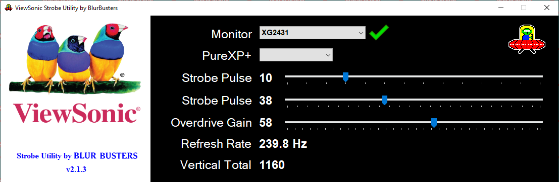

I found the guide pretty easy to use. One weird thing, not sure if something just got very minorly broken during my install, but the UI for my app is a little off.
Two items called "Strobe Pulse". They still adjust the expected parameters, but it doesn't 100% match the guide. As I ran through some tweaks, I also found combinations of settings that would reset the strobe pulse width to 100%. Adjusting width or phase by 1 value in either direction would "fix" it. Might be a small firmware issue?

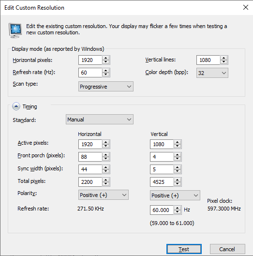

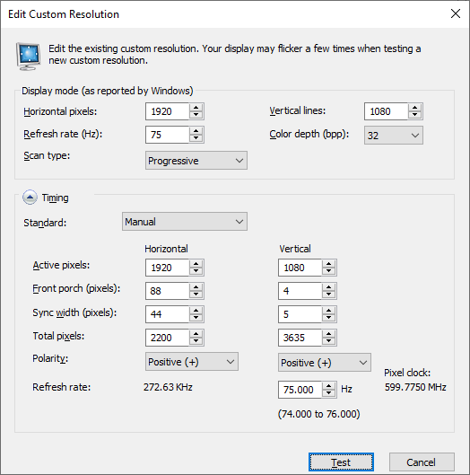

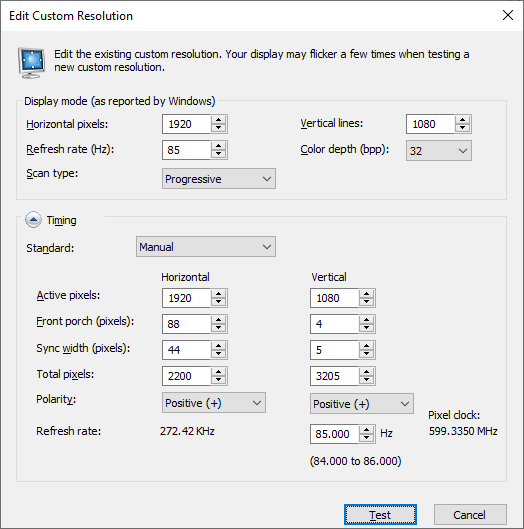

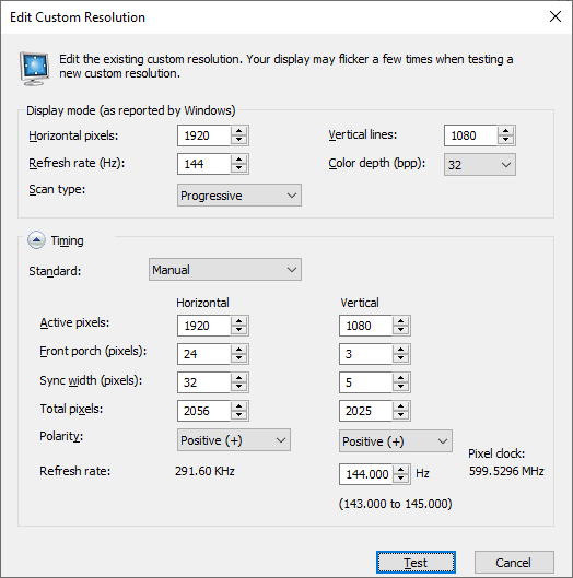

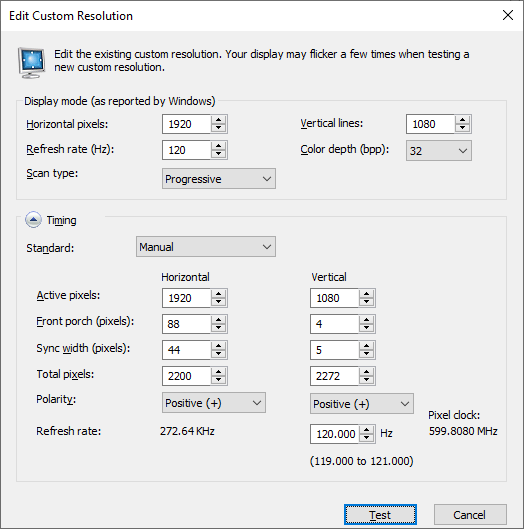

I made some custom resolutions for 60hz, 75hz, 85hz, 120hz, and 144hz using the NVidia tool. These values may not transfer 1:1 to CRU, I'd say I put enough effort into all of them to say they're probably 95-98% optimal settings for QFT.
custom 60hz.png (20.39 KiB) Viewed 10456 times
custom 75hz.png (20.31 KiB) Viewed 10456 times
custom 85hz.png (20.32 KiB) Viewed 10459 times
custom 120hz.png (20.3 KiB) Viewed 10459 times
custom 144hz.png (20.34 KiB) Viewed 10459 times
I didn't feel like it was worth optimizing refresh rates any higher since the closer you get to 240hz, the less refresh rate headroom you have left for QFT to make a meaningful difference.
