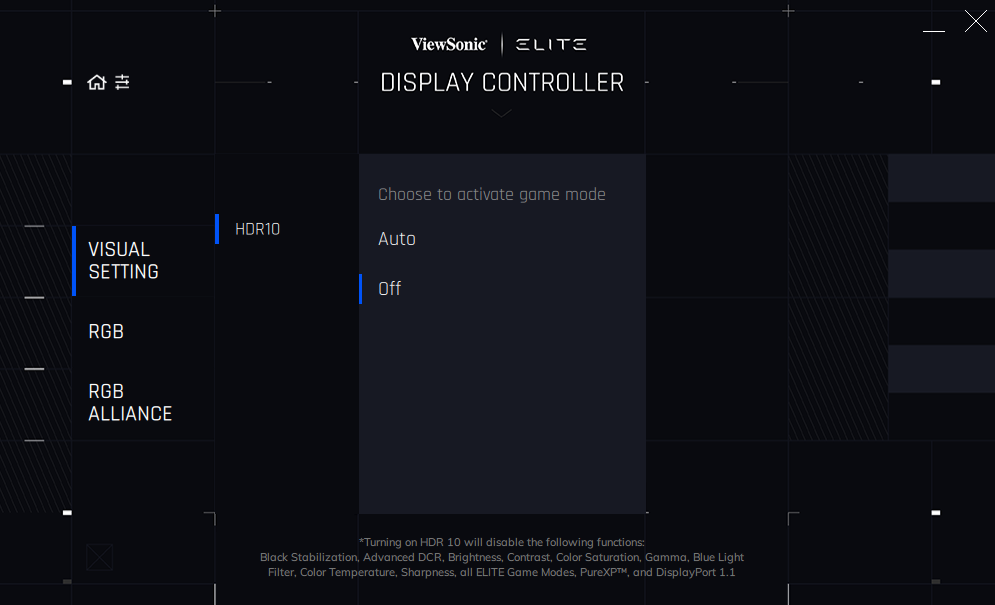

Hi,
First, very good monitor but having problems with the firmware update.
Tried most of the stuff, memory recall, removing custom resolutions etc. Now recently I formatted my computer and downloaded the software and this is the only thing that shows up (see attachment). No pop-ups about the update and when clicking on the options the other one disappear (attachment 2 and 3). Also the profiles seems to be missing on the right side?
Any advice?
Thanks.

Post by Chief Blur Buster » 29 Apr 2020, 02:52
knak wrote: ↑
29 Apr 2020, 02:25
I have already emailed my ViewSonic contacts. Hopefully I will have an answer soon.
While waiting, you may wish to try these troubleshooting tips:
-- Plug in your USB3 cable (included with XG270) to your monitor's USB port, and then reboot your computer.
-- Memory Recall (factory reset) in the ViewSonic XG270 menus
-- Try a different port on the monitor (bypass DDC signalling incompatibility issue)
-- Try a different port on your GPU (bypass DDC signalling incompatibility issue)
