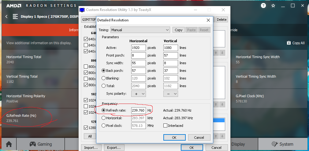

Edit2: refreshrate on CRU show another value in comparison with the AMD driver. Edit3:

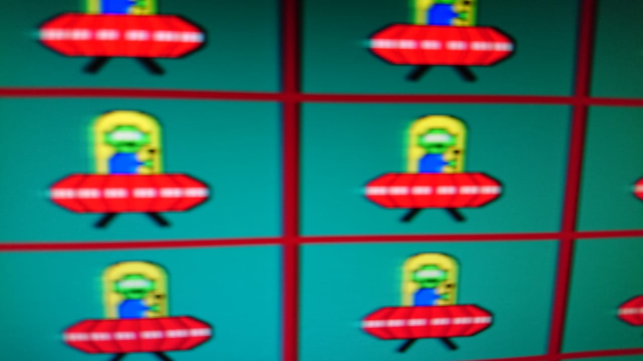

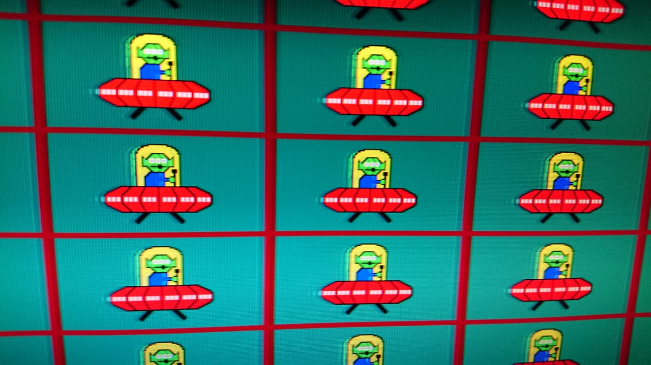

Also some pics with the "fast" setting, with mbr and without Still no freesync...

If CRU is displaying 239,760 you successfully applied the fix. As I see on the screenshot, settings are correct.
The known juddering/stuttering if refreshrate is not exact 239,760 is occuring once/0,5sec - once/1sec, if you're getting lower judder rate, probably I havent seen that kind of issue.
