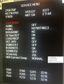

Thanks for the test !!! Say the firmware version of panel, make a screen service menu
1. Power off, then power on
2. Push left 3 times, then right 1 time, and then press the joystick button
3. Then press left or right and you should get in service menu.
