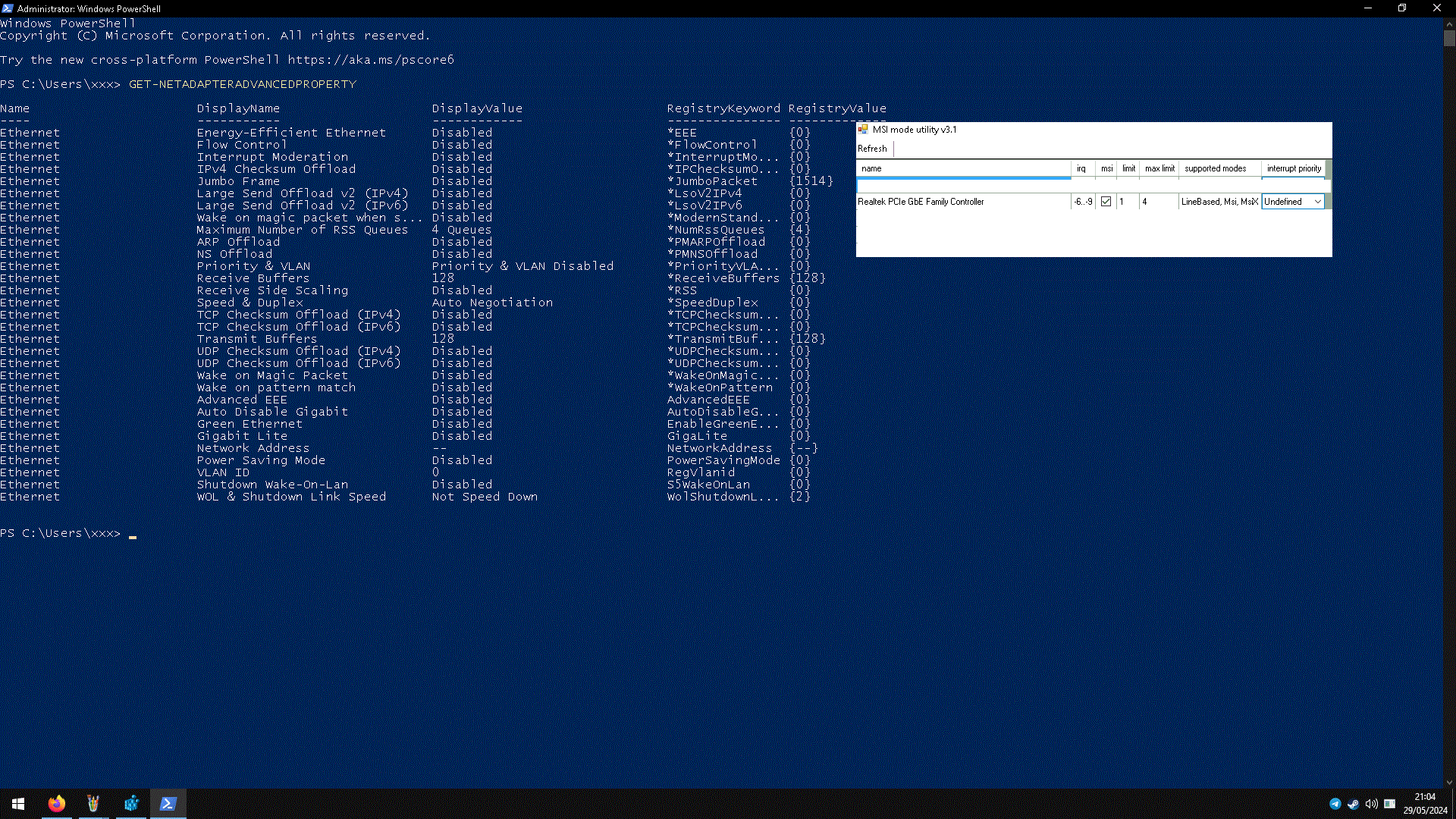

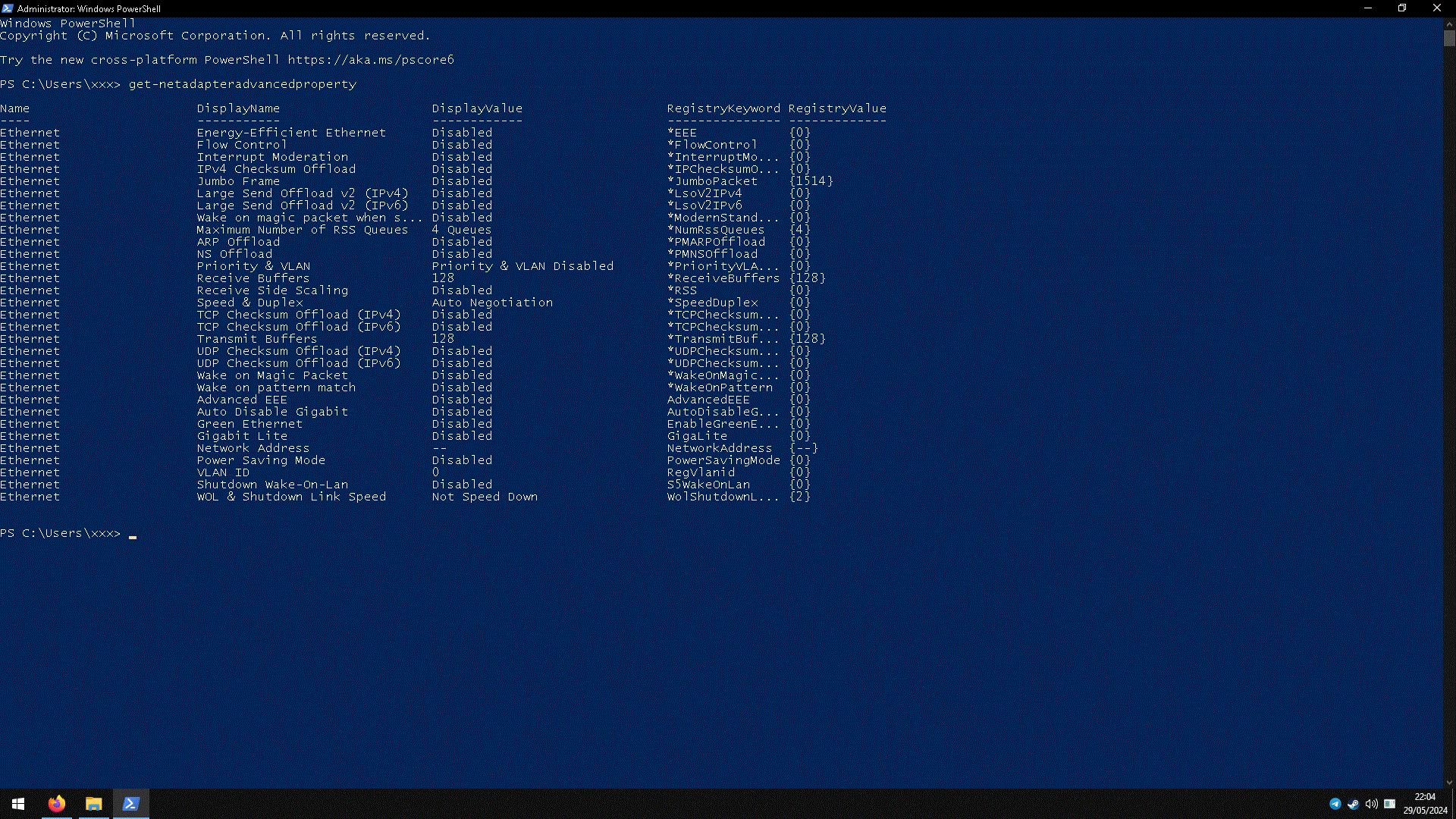

Post by JimCarry » 29 May 2024, 12:57
jassine wrote: ↑
28 May 2024, 13:46
JimCarry wrote: ↑
27 May 2024, 15:13
ok thanks,can you test this thing that i show on the screen as well,so this is default on the picture but when you change msi limit to more then one in my case max is 4 ,when i change it to 4 i have from 1 "irq 4294967290 Realtek PCIe GbE Familly Controller"
to 4 irqs "irq 4294967290 Realtek PCIe GbE Familly Controller"
wich in theory is better but can you test it as well?
as u see in the image below, i have limit = 16, so i have 16 irqs, according to chatgpt this is how to get your best value :
For most gamers, starting with an MSI limit of 8 and adjusting to 16 as needed can strike the right balance between performance and stability. Always tailor the settings to your specific hardware and gaming requirements, and perform thorough testing to ensure the best possible gaming experience.
and for RSS, these are my settings:
Using 2 queues with 2 cores: 12 and 14 and NUMAStatic as profile, till now, my gaming experience has changed, no more delay.

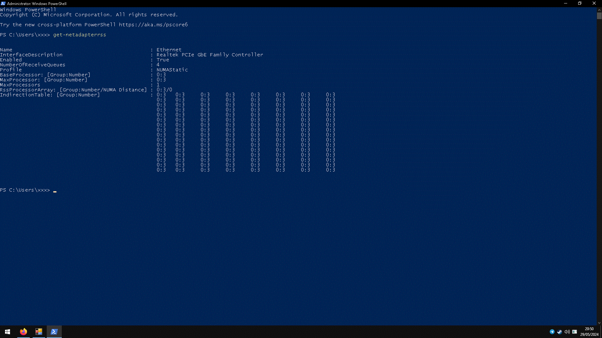

If we compare your screenshot and mine the only diffrence we have are in:
NumberOfReceiveQueues i have 4 you have 2
BaseProcessor: [Group:Number] : 0:3-mine
MaxProcessor: [Group:Number] : 0:3-mine
BaseProcessor: [Group:Number] : 0:12-yours
MaxProcessor: [Group:Number] : 0:14-yours
MaxProcessors : 1-mine
MaxProcessors : 2-yours
I think you see diffrence because of this exact thinkgs.Can you show me hot to change to see like yours,also 3 days ago u did even have rss now you add it by hand and you see diffrence this is what excatly i said,if it works its night and day difference,and we must prove it by benchmarks or something so can people try it.

Post by JimCarry » 29 May 2024, 13:08
Kyouki wrote: ↑
29 May 2024, 04:22
Personally, had tested with RSS for some while as well until I read somewhere it created more problems or doesn't work as well as it does and adds nothing to Gaming specifically.
I took it off, and it resolved some of the packetloss problems or issues I was experiencing.
Take it with a grain of salt and do experiment (which is why I wanted to follow this thread if I did something incorrectly)
Ok big man thanks,so bassicly this is what my settings should look like:
Also what must be my interrupt priority when i install fresh net drivers its always High
Also what must be my Transmit / Receive values be ? i did try 64 128 6144.
