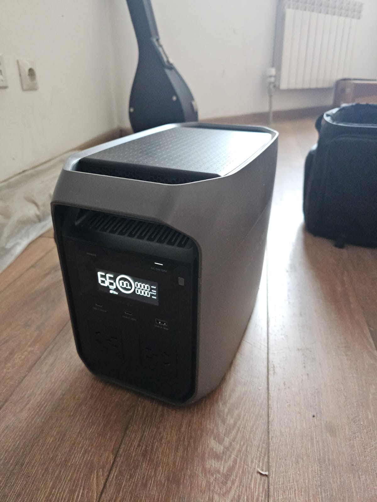

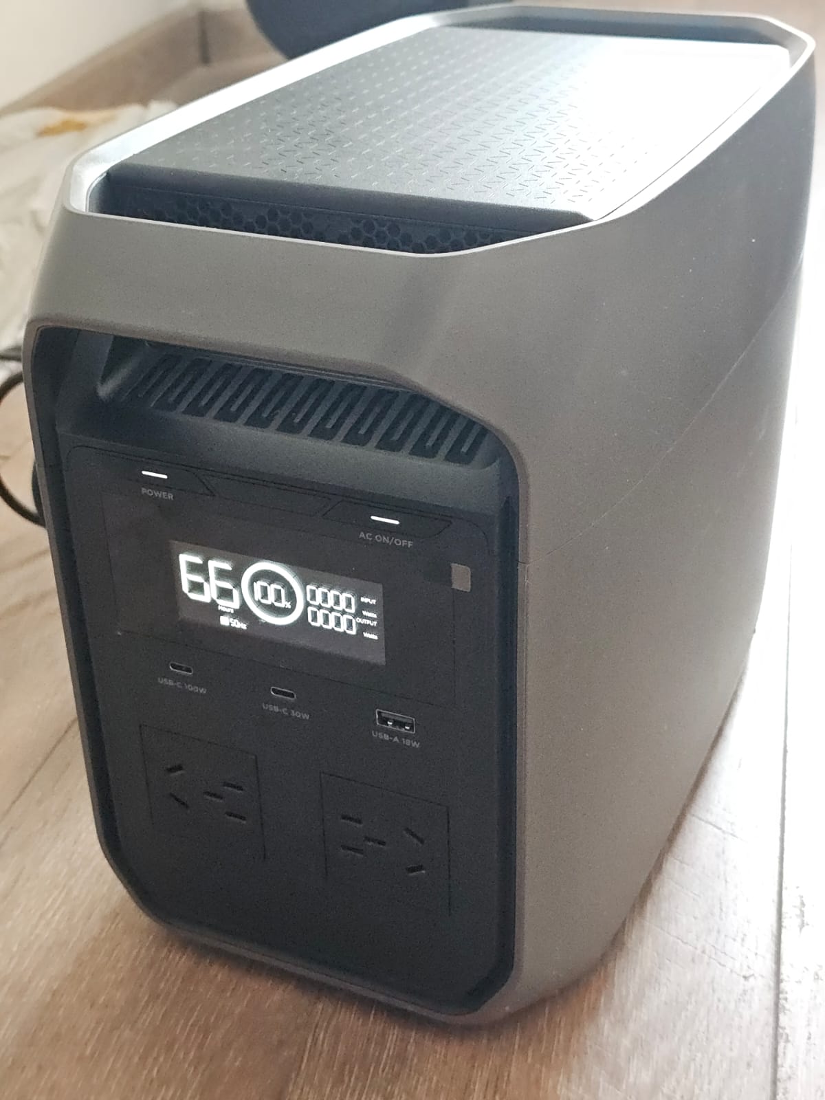

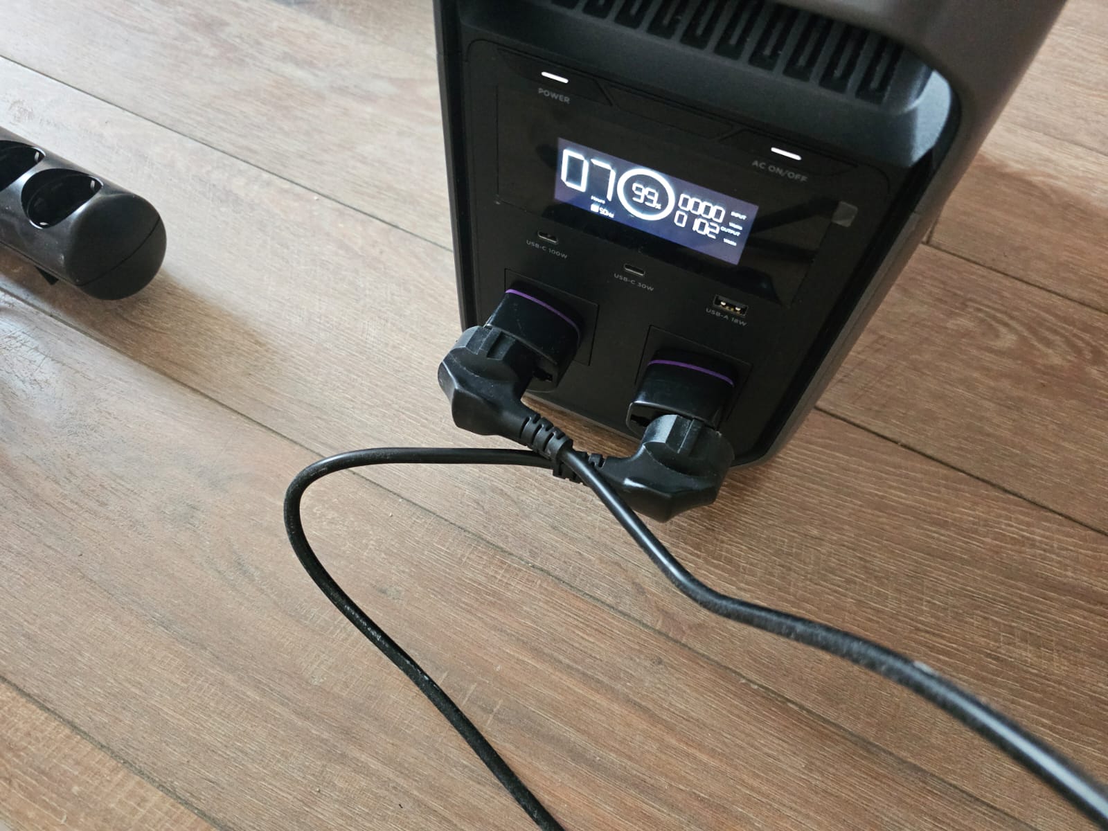

To further confirm that an independent power source does not solve the problem, yesterday I rented an EcoFlow DELTA 2 portable power station for one day. It arrived already fully charged, so I did not connect it to my apartment’s power grid at any point before using it.
I powered my entire computer setup from the EcoFlow while it was operating completely off-grid. The result was zero improvement — nothing changed at all. I also do not notice any significant improvement at night.
Yes, I understand that the EcoFlow contains an inverter that generates its own EMI. However, even with that in mind, I believe I should still have noticed at least some difference compared with powering the computer directly from the apartment’s electrical grid.

You're forgetting one detail the generator's neutral isn't grounded, so it's floating. As a result, you'll feel the same sensation as with the electricity in your home.
