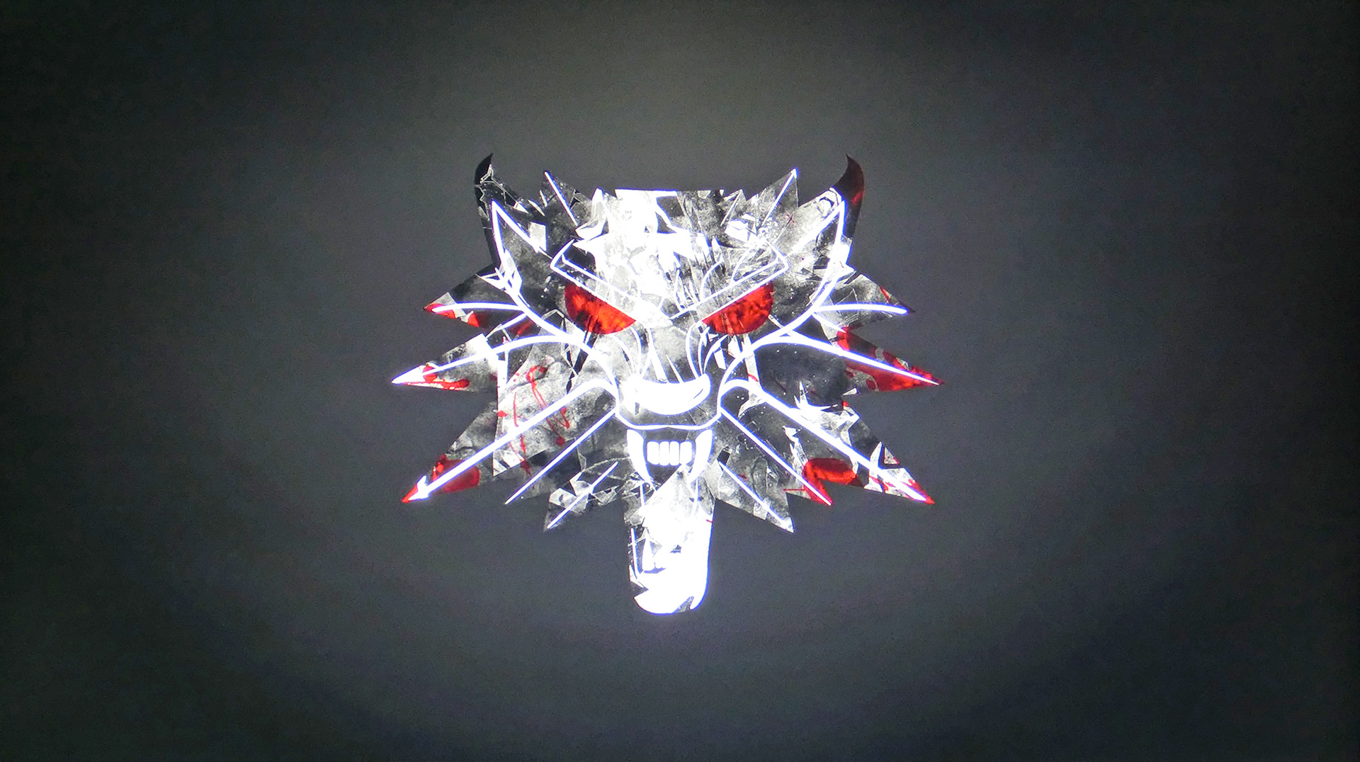

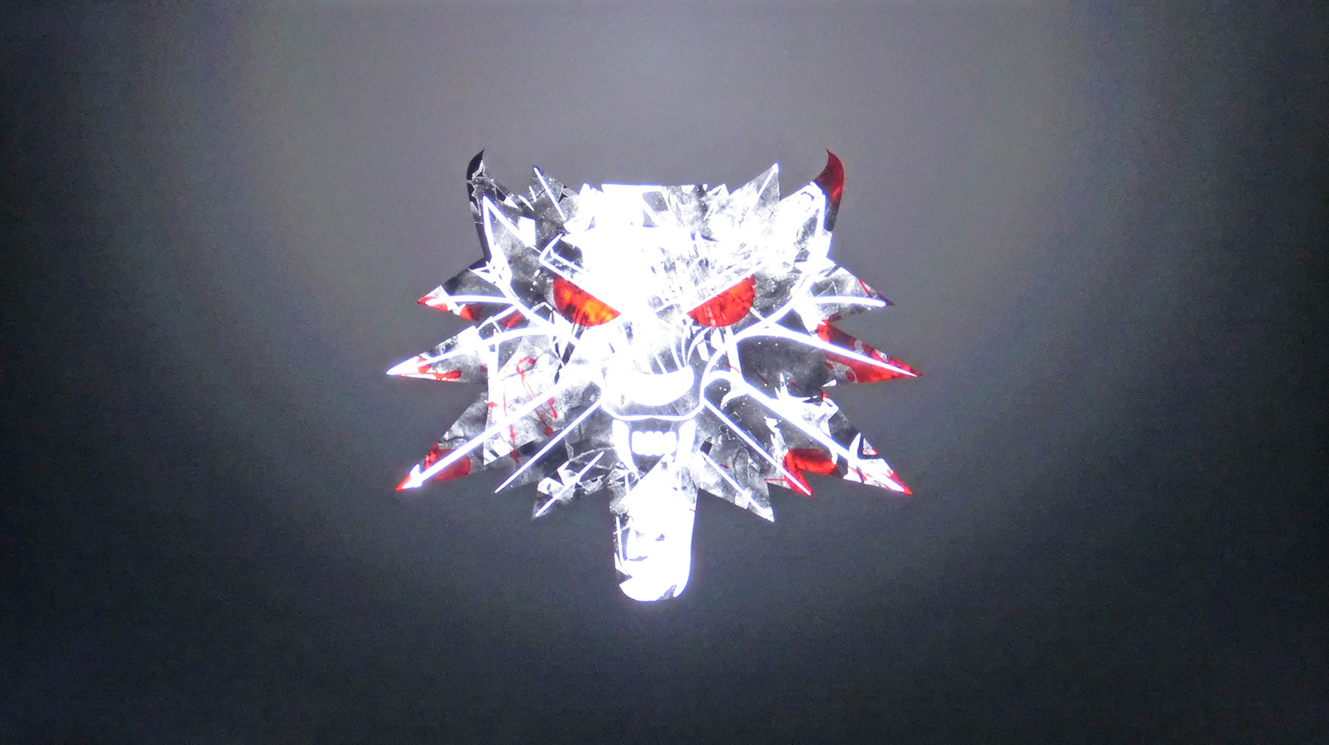

Okay, to preface, my camera couldn't capture the color differences between the XB252Q and the XB271HU accurately, so I skipped those tests.
Both the monitors were calibrated to 120 nits, 6500k, 2.2 gamma. The below images do not accurately depict brightness, as I purposely blew out the brightness on all images in Photoshop to expose the gradient banding fully (you see much less of this exposed in person on both monitors).
The black levels and general exposure of both displays DO NOT look like this in person.
Original test image #1
XB252Q (240Hz 6-bit FRC to 8-bit TN):
XB271HU (144Hz true 8-bit IPS):
Original test image #2
As expected, the IPS has less banding overall, but remember, these are the original images that contain banding in the source.

Posts: 4640
Re: Do all TN G-sync monitors have banding issues? Help me p
Post by RealNC » 23 Sep 2017, 00:14
This looks more like a lack of dynamic range due to wrong gamma tracking. Not sure if it's due to 6-bit. Probably just due to wrong gamma.
@OP: Can you try adjusting the gamma while viewing the images? If adjusting the gamma on the monitor's OSD won't help, can you try the gamma slider in the driver configuration panel?

RealNC wrote:This looks more like a lack of dynamic range due to wrong gamma tracking. Not sure if it's due to 6-bit. Probably just due to wrong gamma.
I already considered this, but these were rushed, non-scientific tests to prove a point that banding can be due to the source images, not the monitors themselves. 6-bit or no, the TN is going to be more difficult to capture accurately thanks to gamma shift inherit to the panel type (I'd need to move the camera even further away from the screen to rule that out more fully, and I was short on placement space).
That said, devoid gamma tracking (both displays were calibrated in DisplayCal with a colorimeter), it is common sense that 6-bit FRC may have more (especially color) banding (maybe not quite as much as in the comparison photos) than true 8-bit. Note the two displays are closer in banding levels with the grey gradients than with the color gradients.
