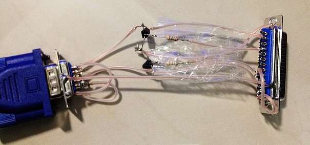

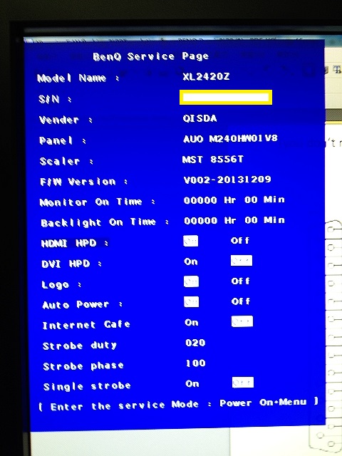

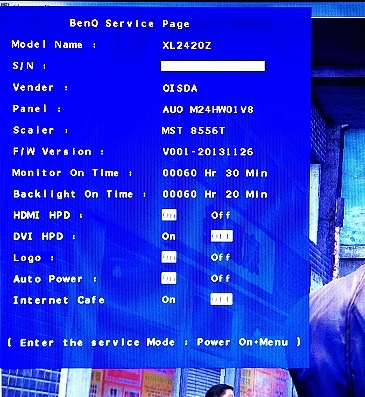

Thanks for you all sharing, due to Benq Taiwan hasn't support V2 firmware service, I followed this discussion and try to upgrade my XL2420Z and it works. :D
I use 75ohm resistor and c33725 transistor and it's working fine when upgrading V2 firmware.
:oops:
before:
:roll:
after:
:lol:

magicjake wrote:Thanks for you all sharing, due to Benq Taiwan hasn't support V2 firmware service, I followed this discussion and try to upgrade my XL2420Z and it works. :D
:oops:
before:
:roll:
after:
:lol:
Great that it works! Now you can use the Blur Busters Strobe Utility!

I found a PC with parallel port (and admin rights) and the update was successful! I had to flash it twice but then it worked and the service menu shows V002. :D
Thanks for all the help, without your pictures/guides I could never have done this! Actually I still can't believe that my DIY cable really worked. ;)

You can test your cable with a multimeter. Do a short curcuit test on direct connections. E.g. collector to collector, ground to ground. And a diode test with the plus(red) cable on the resistors and the black on the collector wire.

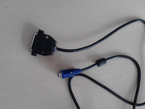

Picture of cable attached.

Maybe the wiring of the transistors is incorrect. Base to resistor, emitter to ground, collector to the pins? little beasts

lebowsky wrote:Maybe the wiring of the transistors is incorrect. Base to resistor, emitter to ground, collector to the pins? little beasts
What kind of transistor do you have? There are 2SC trans. which have the collector in the middle ( ECB) and there are C trans. which have the base in the middle (EBC). Apart from that yep, that's it. Did you beep all the connections through? In case it still doesn't work, post a photo maybe.
